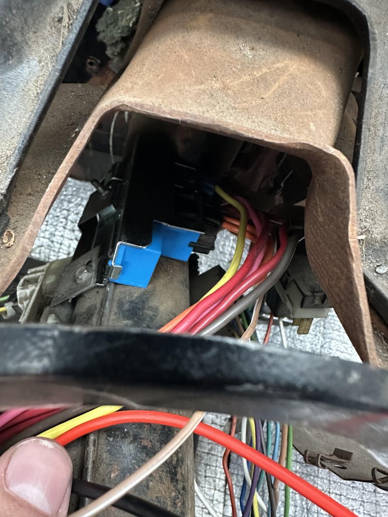

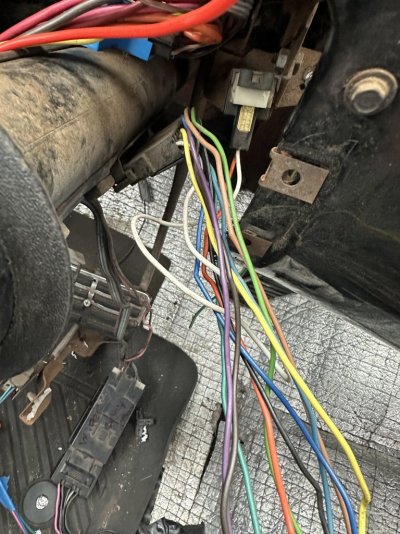

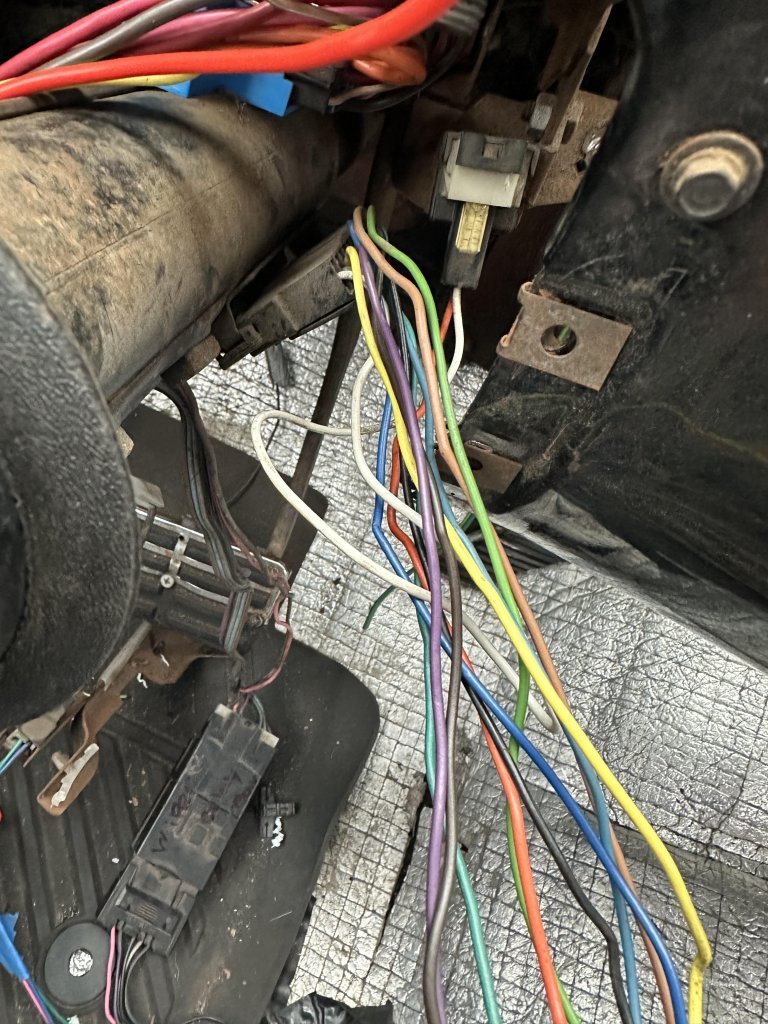

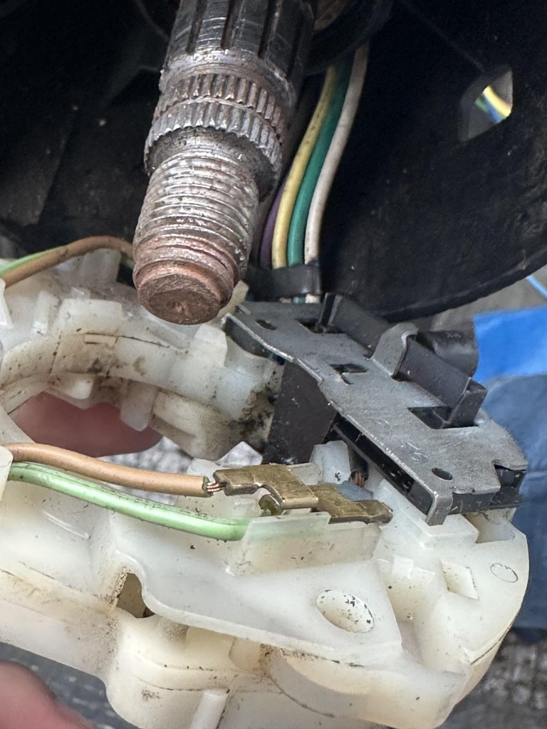

I have 84' C10 that is pretty much completely gutted inside and out, it has a Ls and 4l80e in it. Before this month it was wired awfully from the swap with a rat nest of unused wires hanging around under the dash. since its engine swapped and only has exterior lights, no blower radio dome light or anything else electrical i was only utilizing about 12 wires total (other than the ECM harness that is basically completely separate other than the ignition wire). I marked every wire i could and using the fuse box and a multi meter, and diagrams. Currently the only wires i need to use from the factory harness are the ignition wire (which I'm still using the factory ignition switch and have that wired), turn signals ( maybe hazard but don't care for it) wipers and brake switch for the rear brake lights. other than that i wire have the parking lights wired to the ignition wire from the ignition switch and headlights on a separate aftermarket switch. currently i have everything cut out except the i think 8 pin connection that runs up the column. I've found multiple diagrams but what i never understand about them is where they get power from, each wire is labeled to its respective place i.e rear right lamp turn signal and such. but the wires only come out of the column i have no idea where they are supposed to draw power from, since I'm wiring it with such few wires i have a OEM fuse box I'm running off the ignition wire to all these lights so i cant accidentally leave them on, but what wire in that 8 pin connector bring voltage in to distribute to the turn signals flasher and such, I've attached pictures of the only wires i plan on using if possible. thanks for any input as i continue to try and rewire this as simple but safe as possible.
1st picture is the plug on the right side of the column. 2nd is of the ignition switch with plugs, 3rd is the wire at the steering wheel side of the column where they go into a component that has the blinker arms attached to.

Power comes into the truck on 2-3 heavy gauge red wires. One goes to the headlight switch and other items that are powered at all times, the other goes to the ignition switch. The ignition switch splits the power up by function. I don’t have any manuals handy, but I do remember an orange, brown, pink, and I think blue. I do know pink powers ignition related components. The orange powers things that are suppose to work in “Run”, I think the brown powers thinks that are intended to run with the key in “accessory”. There will also be a yellow or purple wire with yellow tracer, that’s your “crank” signal wire.
Before doing anything else, make sure you have the connectors to the ignition switch fully seated. Next, turn on the ignition, and use a test light to check for power on both sides of each fuse in the fuse box. Note that the fuse labeled “lamps” will only show power with the headlights on.
Once you have verified which fuses are powered and dead, it will be easier to figure out the next step.

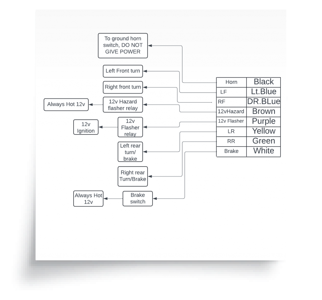

I gave up on googling answers and just put my multi meter to work, basically came to the conclusion GM is smart but also not obvious about where wires go, i attached a picture with a wiring scheme i drew up quick. I'm aware of what wires i need on the ignition switch it was only the wiring going up the column to the blinker assembly that tripped me up, 12v flasher is a supply wire Brake is a 12v supply wire only when the brake pedal is pushed and hazard is a 12v supply wire when the hazards are on. they switch responsibility of powering the rear turn/ brake wire through the blinker assembly. Guess sometimes you just got to figure stuff out the hard way but its done now and I'm onto wiring in my ECM Air ride ECU and compressors.

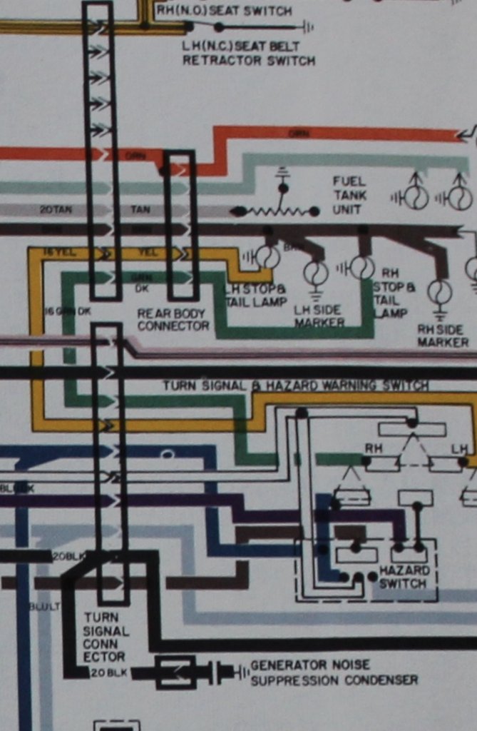

The nice thing about GM is they have used the same basic wire colors for certain functions since the 50s.
This is a screenshot of a factory wiring diagram for a 72 Olds. I’m 99.9 percent sure these colors will match your trucks turn signal switch.

Let’s try this again!
