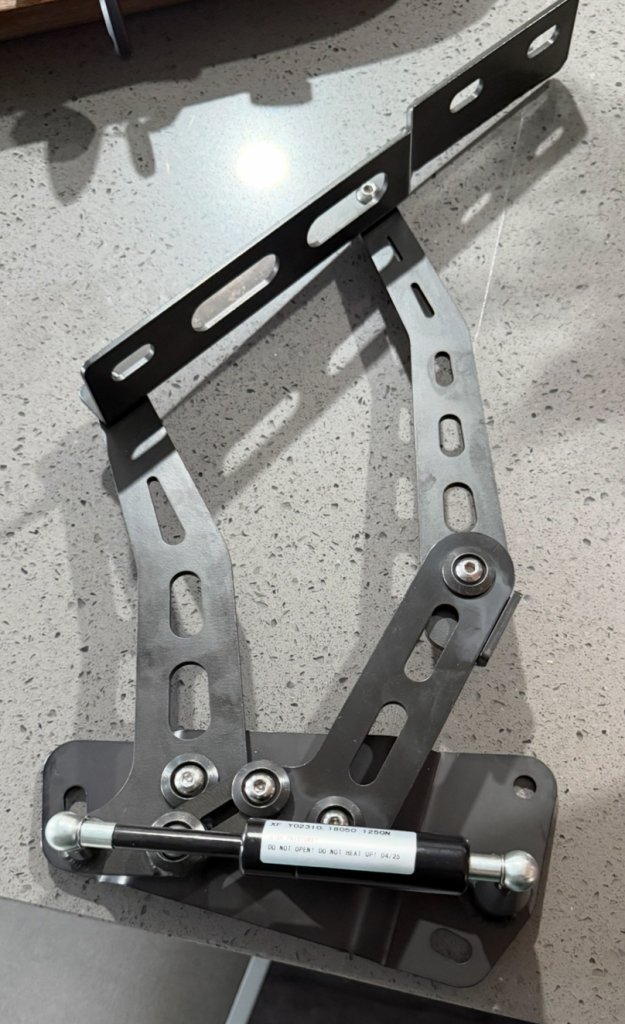

Just recently bought some stamp steel hinges with a gas strut assist from Speedway. Super duty construction. Can’t wait to install them!

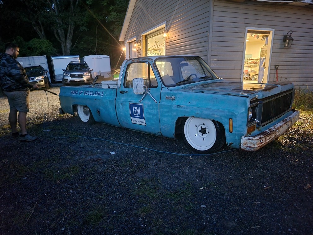

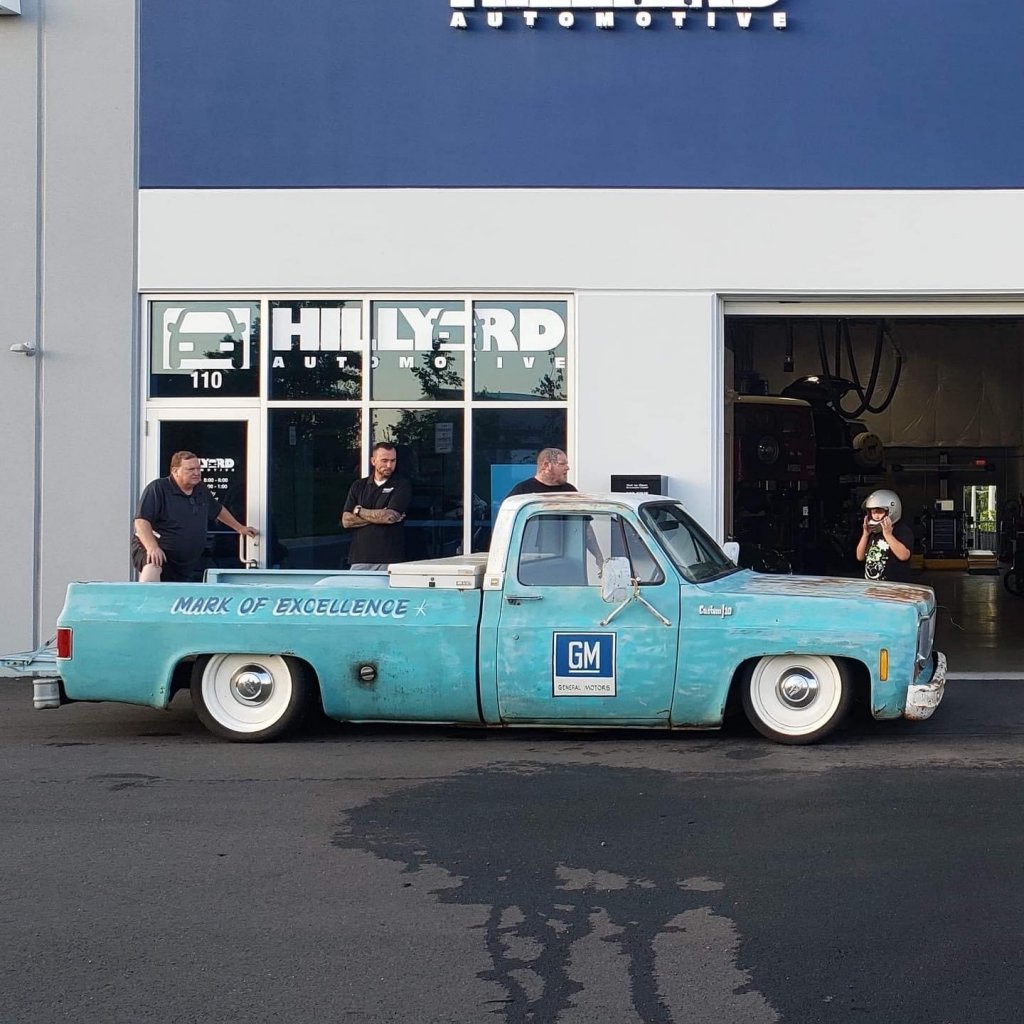

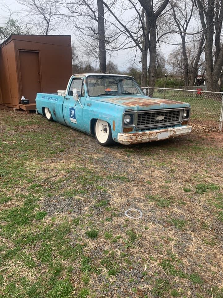

I ended up buying em and also LSfab hood braces. I gotta clamp my hood back straight also went thru LMC truck and bought all new hood latch assembly and hardware cause my latch let go and my hood buckled just enough to tear it. The patina matches the truck to well to replace the hood so I’ll fix and brace it
