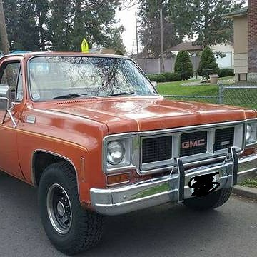

Howdy,
just picked up a 74 C20 Super Custom and the passenger side of my hood is showing signs of the classic "square body buckle". Who uses hood braces? Got recommendations? Lmc has some for 20 bucks and I'm not against being cheap.
Thanks, Bryan

No worries. They are well lubed but if you dont push and pull down the left starts to buckle. Hitting the junk yard today for some fun, if i see some ill snag them. Otherwise ill buy new.

I was thinking the same about making my own. Just wanted a few opinions before i got to far into the project.

Agreed. Everything on this truck is orignal aside from the tailgate. Decent enough paint too. Just curious if others made their own or bought some.
