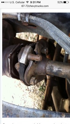

Off the steering shaft or gear? It just bolts to the shaft like this...

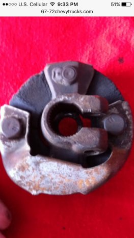

And comes off the gear like this....
