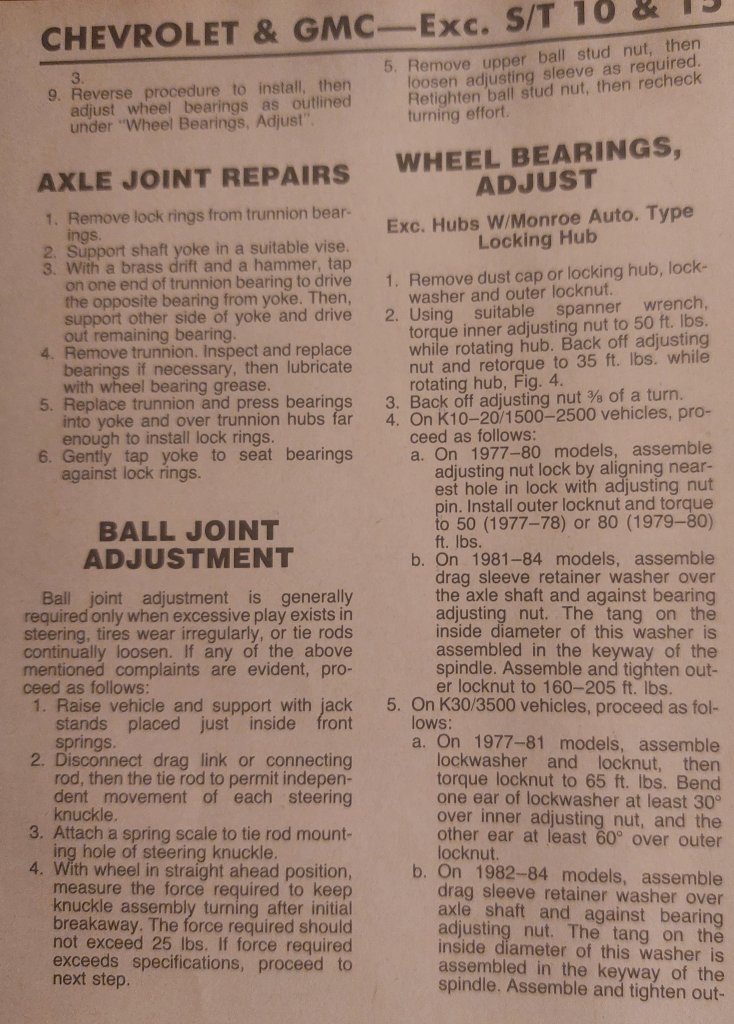

Ahhh! Just read you replaced the steering box,if it's too tight it will cause a problem. Anyway here's procedure for checking the ball joints.
Can I do this with hub and rotor attached ? How do I adjust it if it is too tight?
10,337
20,154
Yes hub and rotor still attached,but steering links disconnected to isolate so the only resistance you get is in the steering knuckle you are checking. Look at step 5 for how to adjust. Sorry so late to reply,been a busy day. Still want to see before and after on alignment sheet.

I'll call them this week, gonna be tough to watch them with work schedule. As for using a fishing scale on ball joint preload, how exactly would I do that? Just hook the scale right onto the knuckle then pull?
