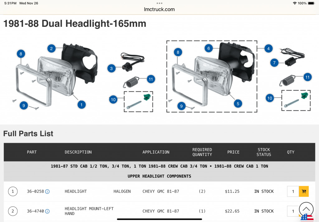

I have been able to pick them up at the local car parts store. Not that I didn’t experience any problems. PITA

I've tried the chain stores. I'm not looking for the bucket adjusters, I need these little pieces that snap into the buckets that the retainer screws into. LMC doesn't have them. Your picture is the 81-88 and mine is a 90 Squarebody. They sell everything but the actual plastic insert.
It's what snaps into the bucket that screw #4, threads into. Earlier trucks are self tapping
