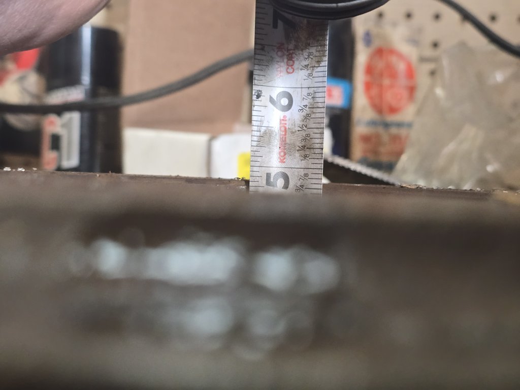

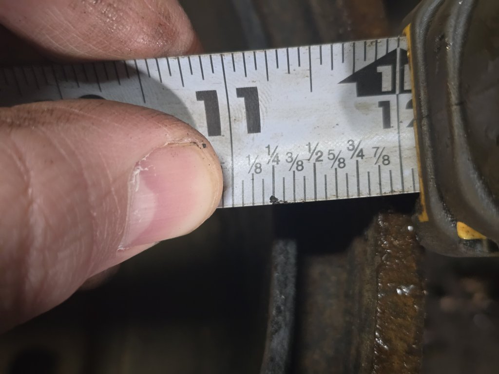

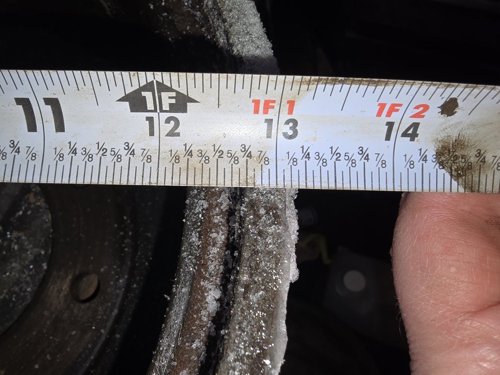

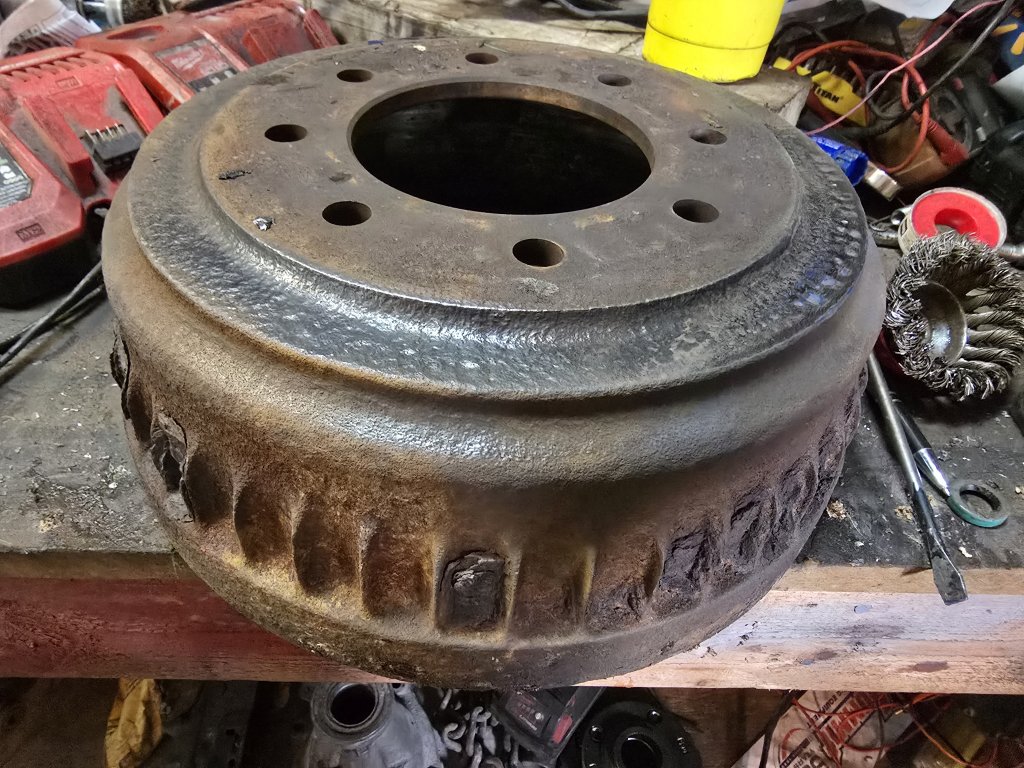

Hey guys, so I bought a pair of 3.42 axles to go under my 82 K20. I'm having trouble finding drums for it. The axles came out of another 82 K20
Every drum I look up is wrong, I've checked every possible GM model that could have come with a semi float rear from 1980 to 2000 or so.
My drum measures a hair over 13 outside diameter, a hair over 11" on the braking surface inside, and if I lay the drum flat on my bench, it measures 4.75" wide. So it's technically an 11" drum. The only 11" drums I can find are too wide by quite a bit.
Any help is appreciated. I can find a 13 inch drum that is 4-5/8 wide.. can I swap out the backing plates for 13" and just run those?
The mounting flange for the backing plate is closer than normal to the end of the axle tube if that makes any sense.

Chevy K-10 Custom Deluxe
Looks like there may be some specs under the paint on the face of the drum. Maybe a part number you could use for cross reference.
