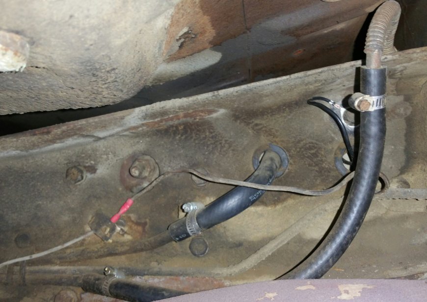

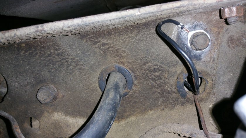

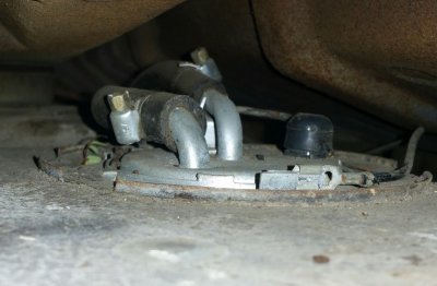

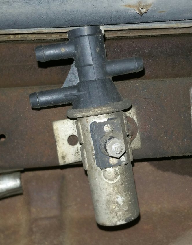

In the pictures I attached you can see that I successfully reattached the sending wire. You can also see the ground wire which seems to be properly grounded. I also attached a photo of the transfer valve which had no hoses attached to it only one black wire which ran to the fuel selector switch. I removed the wire because I didn't see a need for it. Was that a mistake? The fuel gauge still does not work.

Yep, that is a single wire solenoid type tank transfer valve. After leaving the dash mounted select switch, the two gauge sensing legs and the power feed to the solenoid valve go their separate ways. The gauge sensing lines go nowhere near the valve.
Here is the quick litmus test for whether the gauge is working (provided the sensing leg to the sender is properly connected to the gauge):
1. If the sensing leg (from the gauge to the sender) is broken/disconnected the control leg exerts the greater force and the needle on the gauge should peg to Full.
2. If the sensing lead is allowed to contact ground (before passing through the sender), the sensing leg has a greater force and the needle on the gauge will peg low.
Try grounding the lead you've been working with and (with the key in RUN) note whether the gas gauge pegs low.
Are all your other gauges okay? Were you able to locate any part of the original tan gauge-to-sender lead?
That certainly looks like a GM factory sender connector. There's no way around this. You are going to have to determine if the wire that you currently have connected to the sender is actually connected to the gauge a the other end. It doesn't have to be all the way to the gauge but at least into the cab were you can visually verify that it does lead to the instrument cluster. You can do this a few ways; by a continuity check from the sender end to the gauge end, confirm voltage at the connector with the fuse in and no voltage with the fuse pulled, try the test described above and note if the gauge reacts as designed, pull on the wire at one end and see if it moves on the other, etc.

If you're confident that the sensing lead from the gauge to the sender is intact, it might be that the sender is bad.
But given this:
It seems to be connected correctly and did work a month ago until I had some engine work done. Now the gauge needle sits at quarter tank. When I turn the key on, it pegs past full.
I would look for damage to the tan lead (sensing leg) in the engine compartment. I don't know how representative it is, but the wiring diagram shows the tan lead as transiting the firewall at the main connector and then running over to the RH side - before turning and heading back to the sender. Maybe it was damaged during the engine work?

Sorry it's taken so long to report my findings. As the title says, it's just been a bunch of drama. So basically, even though I was able to plug the sending wire back on to the sending unit, the fuel sending unit still didn't work. So first, I pulled an old sending unit out of the trash at work and used that to verify that the fuel gauge sure enough does work. It went from empty to full just as it's supposed to. When I verified that, I knew I had to drop the tank and replace the fuel sending unit. I even connected it directly to the fuel gauge to re-verify that it didn't work before spending $70 on a new one. And just to be on the safe side, I even ran a fresh wire from the fuel gauge all the way to the new sending unit through the firewall and along the frame. But the drama didn't end there...NOW the fuel gauge works, but only reads 3/4 tank on a full tank of gas. I verified from several different sources the part numbers on various websites and various parts stores. (Shrug) Well at least I know I have about a quarter of a tank when the needle hits E. So I guess that can't be too bad....? If anyone can suggest what may have gone wrong, I'd like to know. Thanks for all of your help. :gr_guns::crazy:
