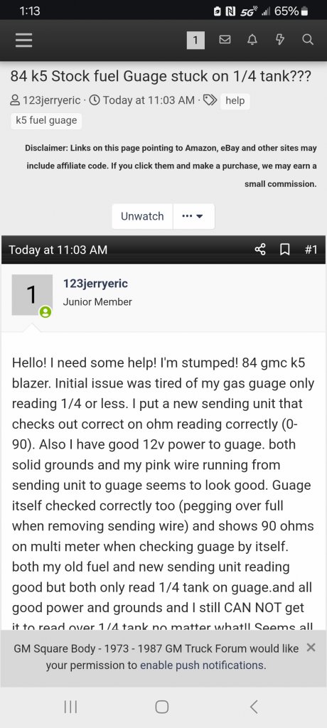

I am having a similar issues my self. I posted a thread also trying to figure it out! I read 65 ohm at new fuel sending unit (about 3/4 tank) but behind guage I'll only ready about 7 ohm (1/4 tank) with key off. And my sending wire seems to be fine (no shorts or pinches) and about everything else checks out too
