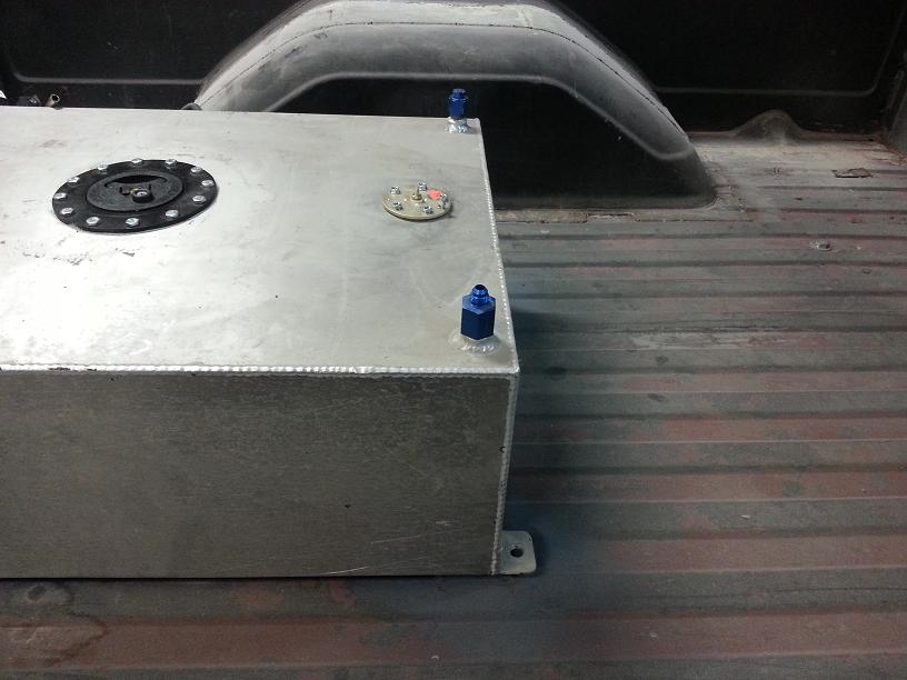

Has anyone worked with fuel cells? Have fuel cell mounted in my bed can I just run the vent out the top of it have the line make a 180 and go down through the bed or does it need more bends? It has rollover ball valve inside tank on this vent output..

heres pic..

shouldn't have any problems running it just the way you said. make sure you secure it to the bed floor where it passes through, so you don't have any problems with it coming back up through the bed floor, and potentially spelling fuel into the bed.

Is there a reason why you chose the middle of the floor? Looks like an after thought and will be a pita to fill :shrug:

Looks like a shortbed, so the filler is close to the rear. A lot of people run a fuel cell right over the axle for better weight distribution and traction.

Ah yes....didn't think of that,Andy :hands:

Yea filler is close to rear not too bad. I did not do it it was already there.. I woulda mounted under bed but either way will be a pain cuz I'm gonna put a toneau on it.

Just get copper tubing and coil it 2-3 times mount it on top of fuel cell
