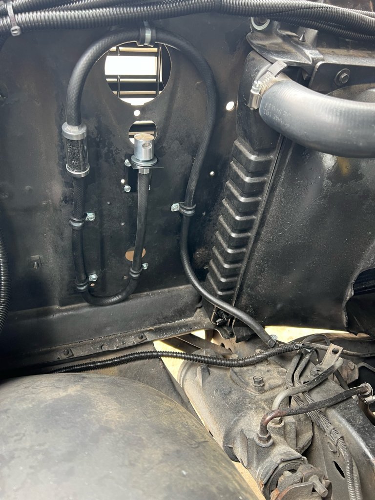

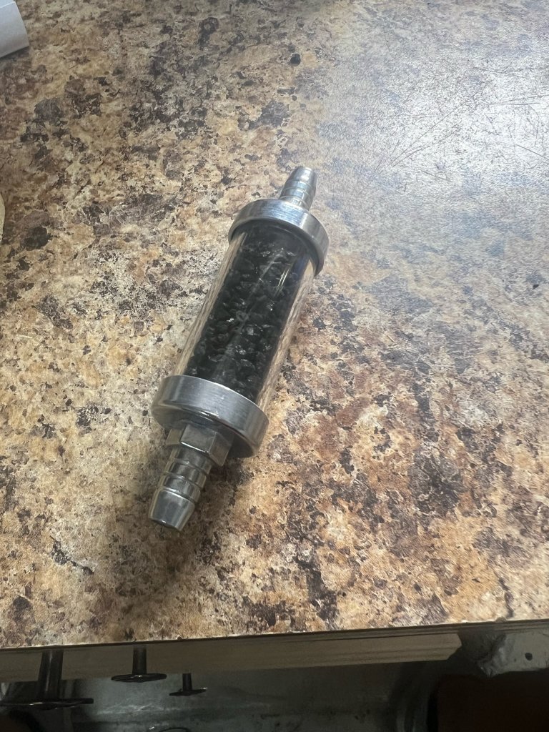

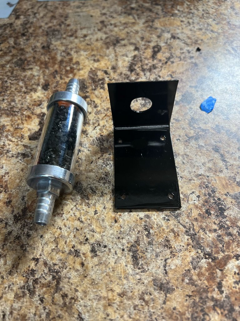

Ken,
we had same issue. PO did the charcoal canister delete 2 port sending unit as well. Found that same steel line under radiator shroud and PO cut it drivers side bottom and that was it. We smelled gas all the time and could not find at the time a canister. I made a small charcoal filter out of a fuel filter and a fuel vent and mounted it on drivers side firewall. Fixed the gas smell and have never looked back.
Not sure if that is what your wanting but here are a few pics
