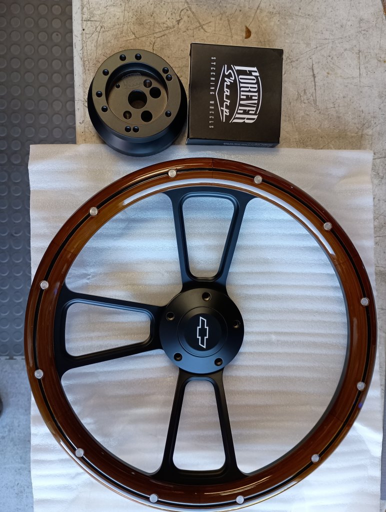

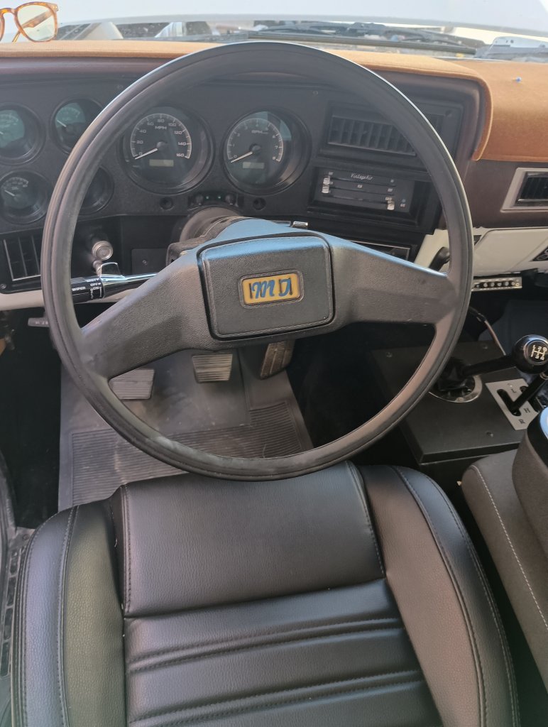

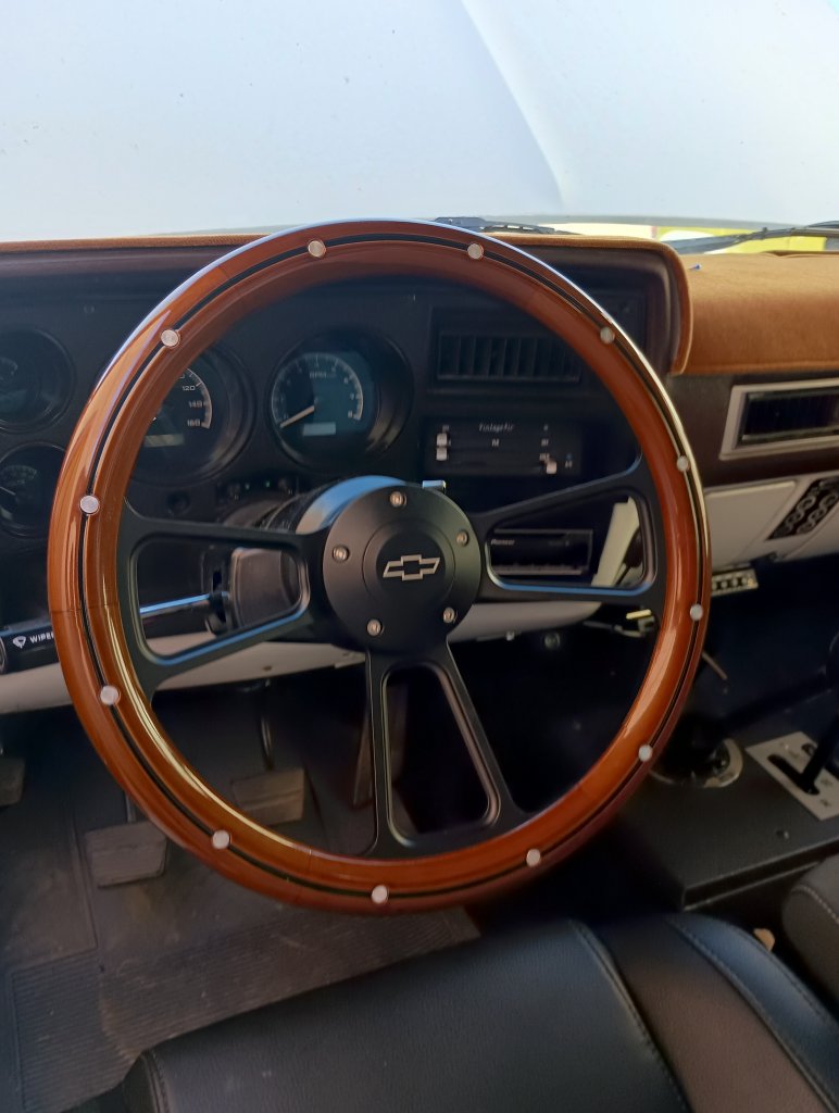

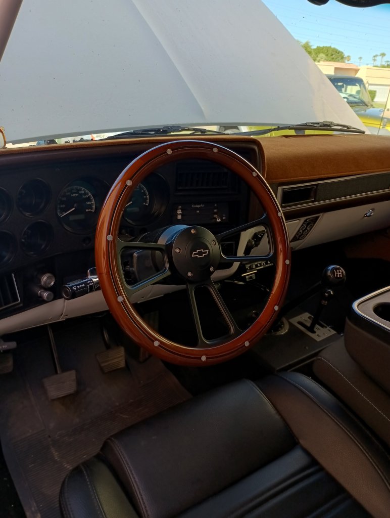

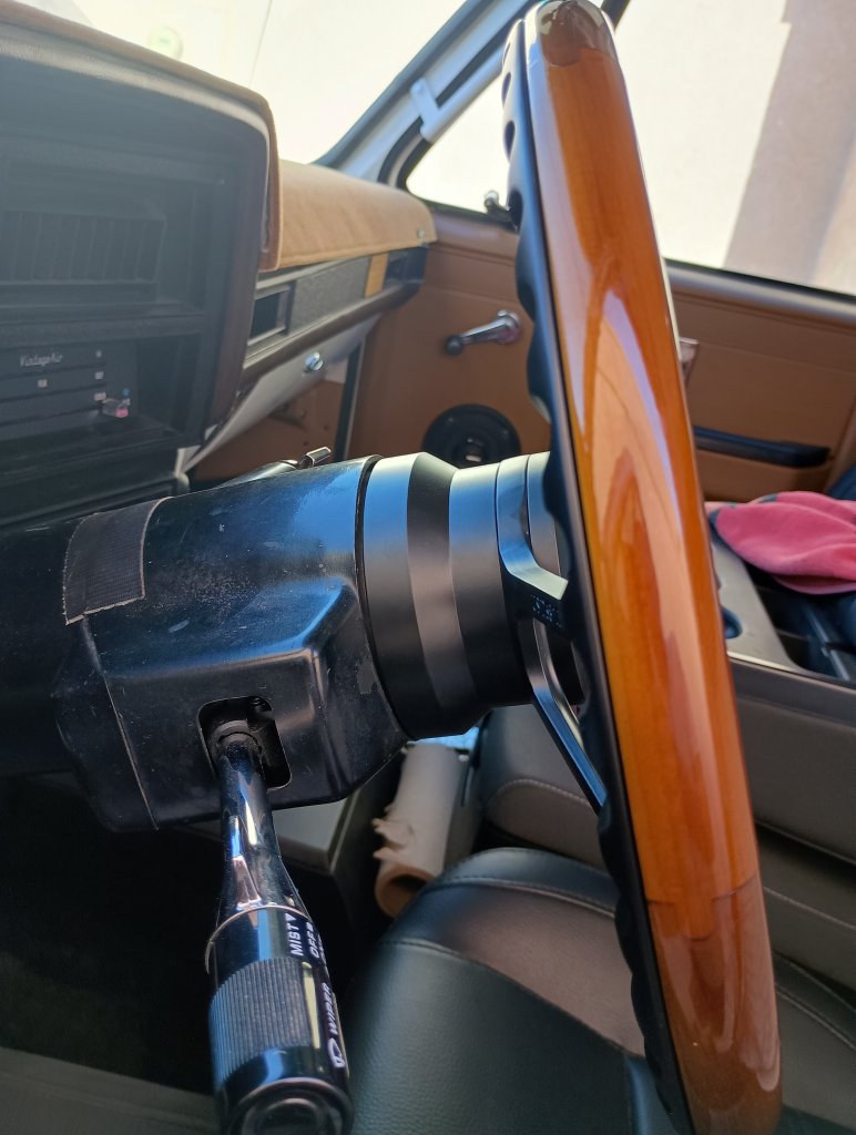

Finally got fed up with the sticky OEM wheel. After much research I found what I was looking for. A half wrap from Forever Sharp. I love it. Thanks to @Old77 for turning me on to this company!
As for the details, it's 14 inch versus the 16 inch OEM. I like it better and gains an inch of lap clearance. Be sure to use the short one piece adapter if you want it to be the same distance from the dash. You will lose 3/4 inch if you order the standard 2 piece adapter. For those of us in the Big Belly Club, that extra space makes a difference.
