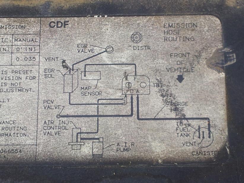

so this would get rid of the air pump and the goofy tubes on the exhaust manifolds???

Yarp! Gotta tell them its from an 89 C/K1500.

This is the diagram on the burb I have... lol
