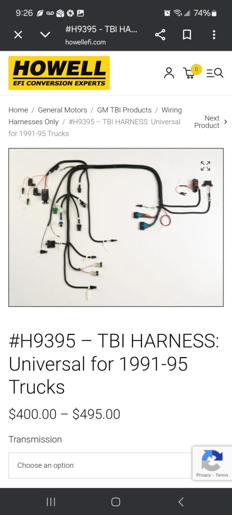

I have no doubt I could it work. But we all have different skill sets. All the underwood and transmission wiring is there,so use it like a stand alone on a retrofit car. That takes care of engine and transmission. Now use your remaining harness fir lights horn etc. Again just like this was a retrofit. There's also the possibility since all the under hood is there to re pin their harness to mate to your bulkhead.
Good point. Depending on how the next couple weeks ago, the Howe harness may be the last resort that would be the least amount of pain/work. The other vehicle harnesses appear to be functioning normal. The only CEL's I've had the last two years are engine related. Helps narrow the focus.
yeah, I think that harness could also work. it might have a few other things you dont need. and you might have to add a few things that are missing. so it is not a OEM replacement, but looks to be a solid 90% solution.
