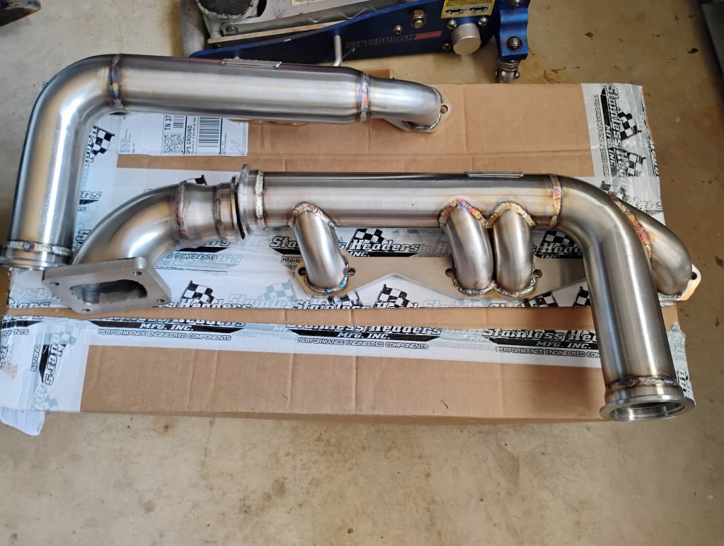

This project has split into a few different tangents slowing progress a bit. After a lot of research and talking to several fabricators I decided to go with a single turbo setup on this project. The other day I received the custom headers I worked with Steve at Stainless Headers on, and they came out fantastic.
Sneak peak at the hot side attached.

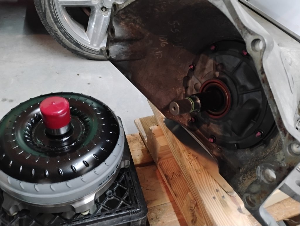

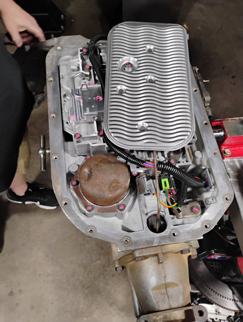

Other work: The block is at the machine shop getting machined, and the 4L80e trans is at the local shop getting a Jakes stage 4 rebuild, with dual oil feeds, 300M shafts and Circle D is working on the 3 disk lockup converter, so hoping to have everything in one location again by next month, and finally get to assembly and get it ready to go to the fabricator.
For more pics of the single hotside now available at SHM https://www.stainlessheaders.com/sbc-single-turbo-headers

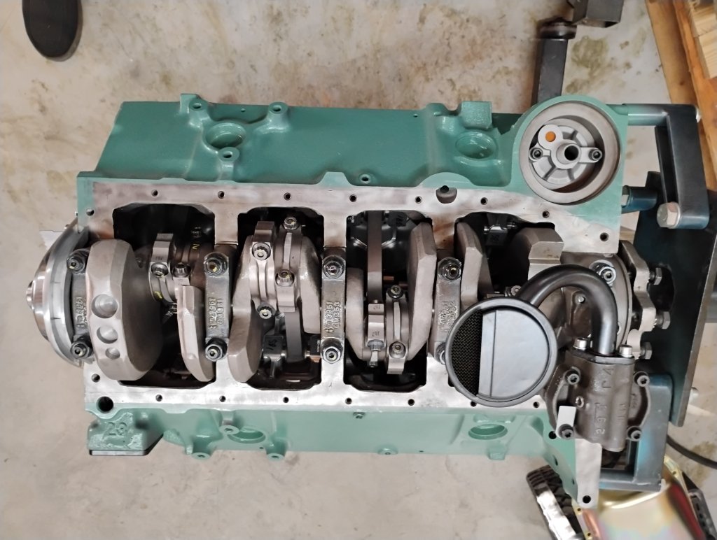

Finally got the block back from the machine shop. I wound up using a bunch of old parts I had laying around from my bracket racing days, and throwing this 355 together.
Big thanks to the boys at Central TN Machine works for bringing this old boat anchor back to pristine.
The crank is a 4340 steel unit that has been balanced with the rest of the rotating assembly.
All forged rotating assembly going together. The block needed a small kiss with the die grinder to provide a bit more clearance for the rod bolts.
Since this is a boosted application, went with D.S.S. -13cc dished pistons forged in 4032. Deck has been "zero-decked" to maximize quench.
Short block going together.

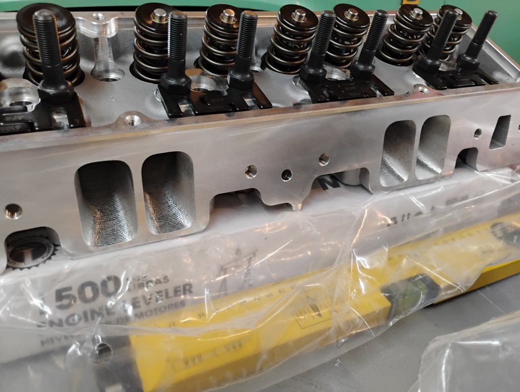

Heads are chicom "NKB" specials, with Manley stainless valves, Comp 987 springs, with VTO Ti retainers I had laying around. They have a 3 angle valve job, with a 33 degree back cut on the intakes. Nothing fancy at all. 2.05" intakes and 1.6 exhaust.
1.5 stainless rockers for now, those may change - Pushrods ended up being 7.250". Not sure how I like these self-align rockers just yet. Since this is a low RPM deal, they should be fine.
For oiling, went with a Melling "sharktooth" unit with the yellow spring, with a 7 quart pan. pan needed a bit of modification to the baffle door thing to clear the pickup screen.
Hoping to have the trans back next month. Been waiting a hot minute for the billet direct drum for the 4L80e, (must be only one guy on the planet making those deals!) but I am told it should be shipping soon. We went with a stage 5 kit from Jakes, since it was the only way to get the super strong direct. I don't think it needs it, but it should live forever behind this 700+HP small block in a 5,000 pound Sub.

Been a minute since I've had time to update here. After a holiday break and a new roof for the house - finally getting back to making more bad automotive choices.
Finally got the trans and all other parts, made a few small changes to the heads, but everything is going together.

Which Melling unit did you go with? I was looking at the standard 55HV/155HV but the machine shop doing some of my work suggested a 10552 when I called them. In that family there are five different variations,just curious as to what you chose.
I went with the 10552ST which is 10% volume over a stock pump. Nothing special, with I want to say the yellow spring. They told me the gears are different they call it "shark tooth" that is supposed to run smoother with less cavitation at higher RPM. Also has a bolt on pickup so no need to weld to the pump. Other than that, not much different from the OG M55.
With this pickup tube: https://www.rockauto.com/en/moreinfo.php?pk=10211036&cc=1034783&pt=5576&jsn=734

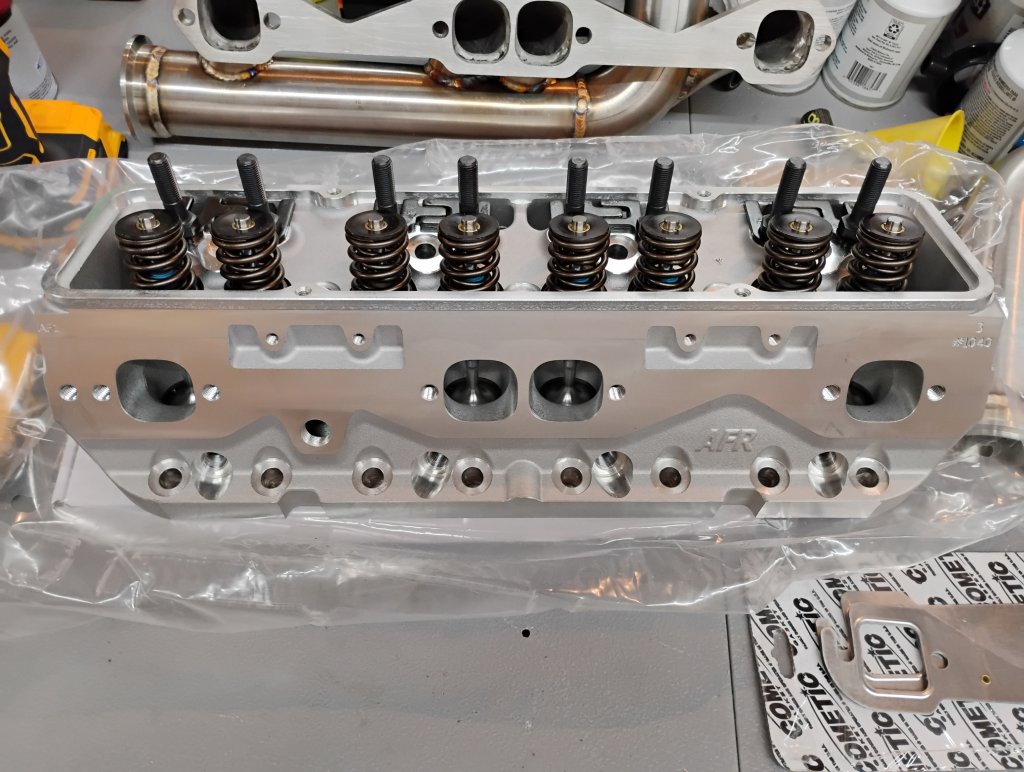

More pics of some of the infra pieces of this build;
64/66 billet wheel RHP800 turbo, Tial wastegate and mac valves. The Terminator will handle boost control. Not pictured is the CO2 bottle and plumbing, plan to eventually run on-board air but for testing and minimizing space will just run the bottle to add dome pressure.
The future "just in case" block that was going to be a 421 stoker, has been destroked to just a 400 cubes with a 5.7 rod - the 3.825" stroke 5.875" rod combo didn't leave enough meat for the ring stack for my application.
Some of the supporting parts for the 400, Manley crank, -16cc dished pistons, and another set of AFR heads.
For rods in the 400, ended up going with Scat ultra I-beam deals. These line up with the target bob weight of the crank a bit better than the H-beam Eagle rods, and should make the balance come in better than running the 628g Eagle ones. This setup should be more durable should the 'Beer budget 355' come apart.
