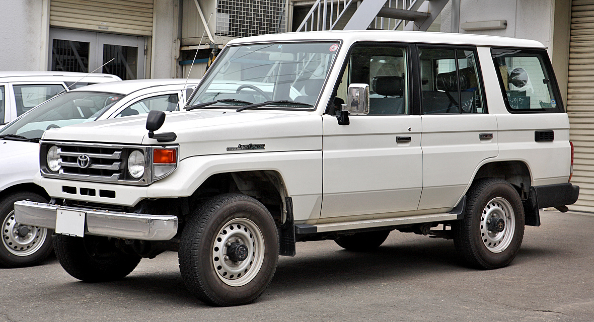

this is a toyota series 70
where I live in new york state, I have to plug in to the state computer for inspection, for anything younger than 25 years. so engine swaps / ecu swaps are for things 2001 and older. (I think one could swing an electric conversion into newer...like get a 2010 gmc with a dead "active fuel managment= killed" 5.3 in it, and swap in an electric engine with batteries under the bed).
