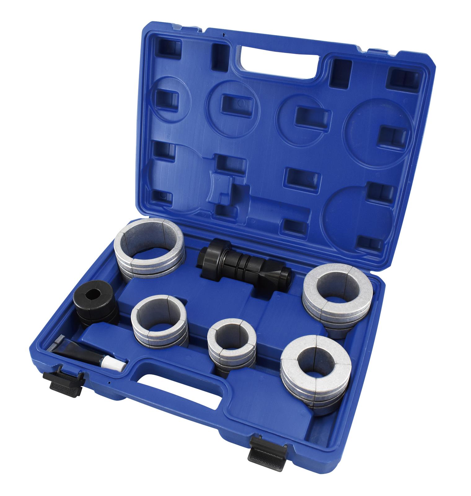

I would step up to stainless or at least aluminized pipe. I like to weld most of it and put a couple of the accuseal style clamps in there to make it removable in sections. One of these makes for easy to weld lap joints and you can expand the joints a little oversize to cheat the bends for alignment if needed. Good luck

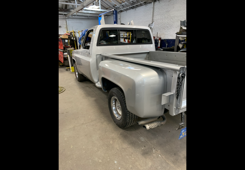

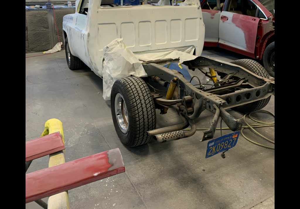

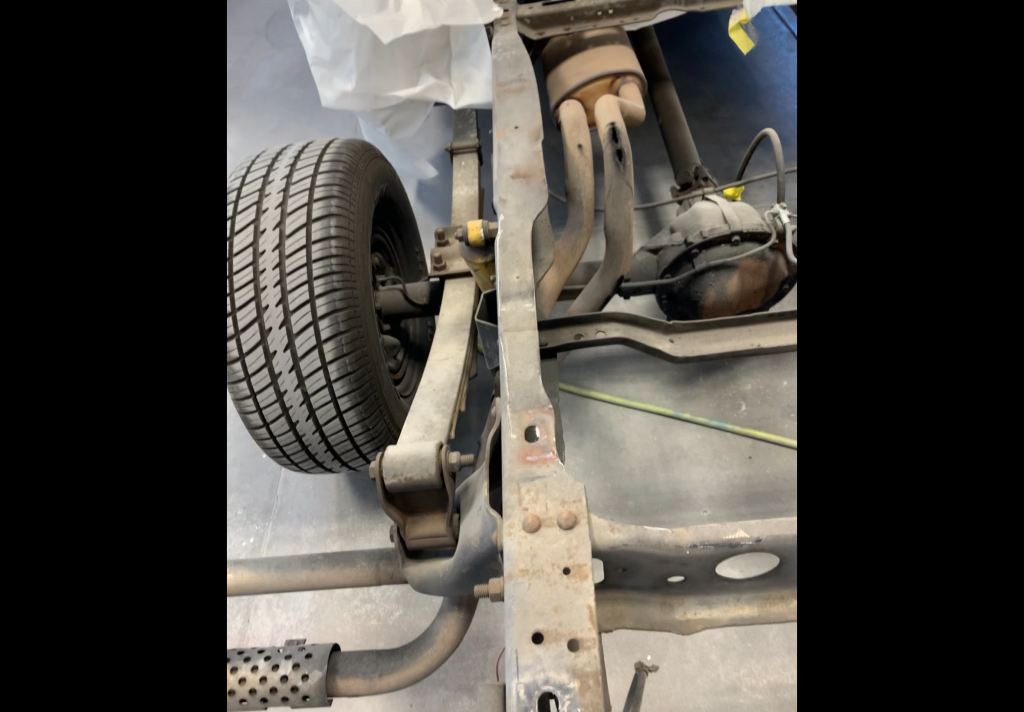

Hi all,
My ‘84 stepside is bone stock, ordered new. I have been searching for a stock tailpipe replacement 2 into 1 into 2 out one side and have not been able to locate. Not sure if all stepsides had that configuration or only with the glide-out spare tire carrier.
