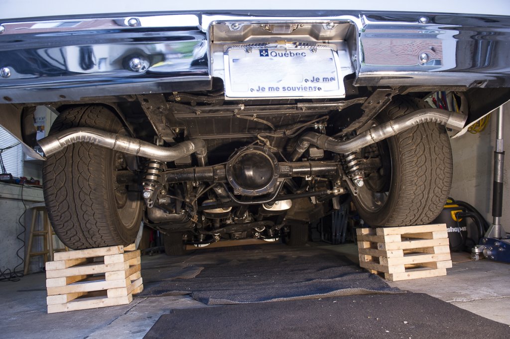

TPISly-C10
Apr 1, 2019
615
896
Boucherville QC Canada
Sly
C-10 shortbox
LQ4 6.0L
LQ4 6L LS here and 2.5" sound great! :)
