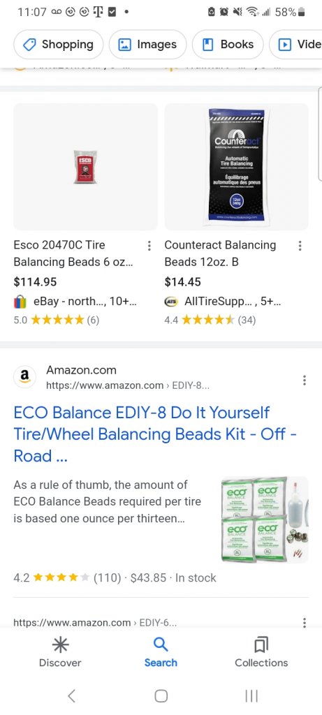

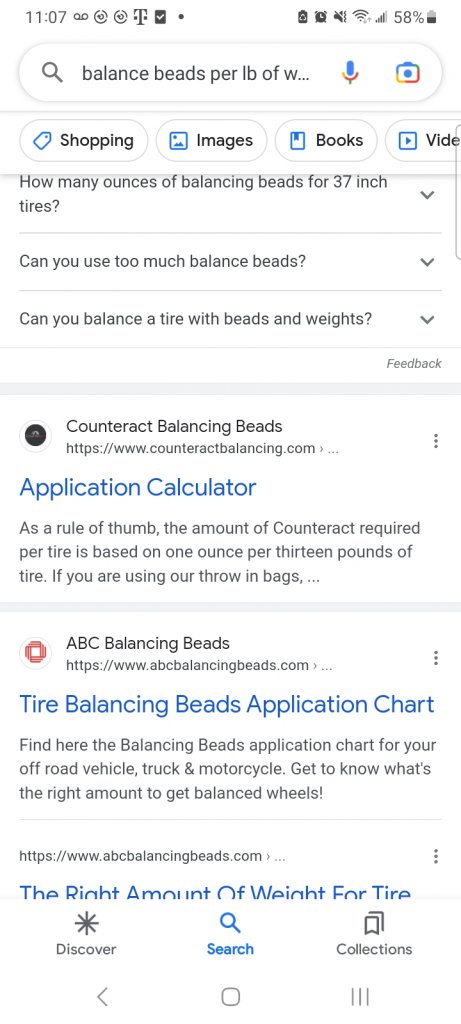

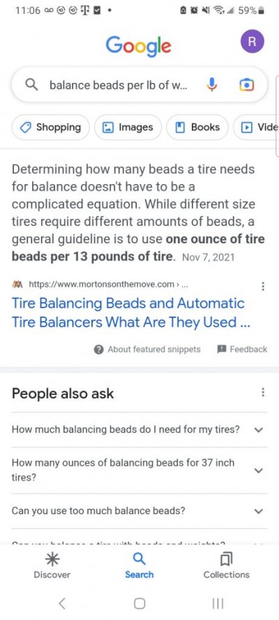

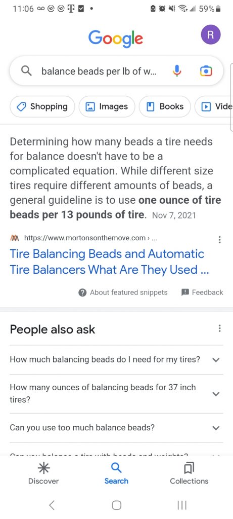

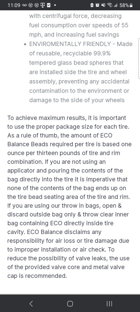

What are you using to determine how much you need?
I was calculating what I need using this
So you put in 2,000 rounds per tire?
That works out to 17.637 ounces, and the chart says you only need 10 ounces.
Which means you need approximately 1,134 bbs.
10,175
19,679
It's 1 ounce per 13lbs of tire and wheel weight. Got that straight from the mouth of the tech guy when I called dyna beads asking about my application.
