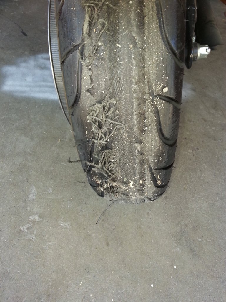

ive had these beads in my Harley best move i made. tires were balanced the whole time till i fried one. hahahaha believe it or not it was still balanced good.. im a believer for sure. it got me home
