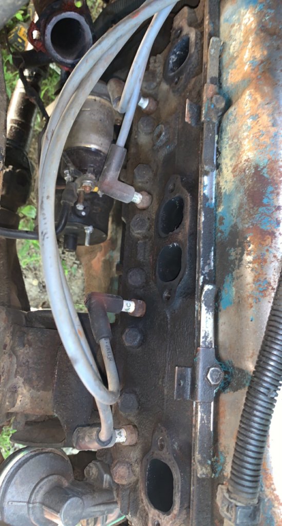

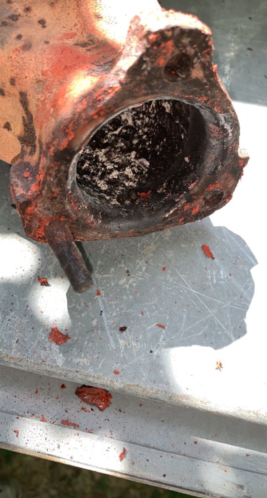

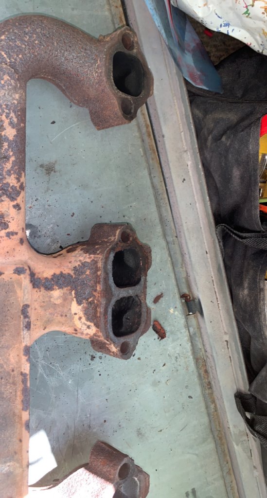

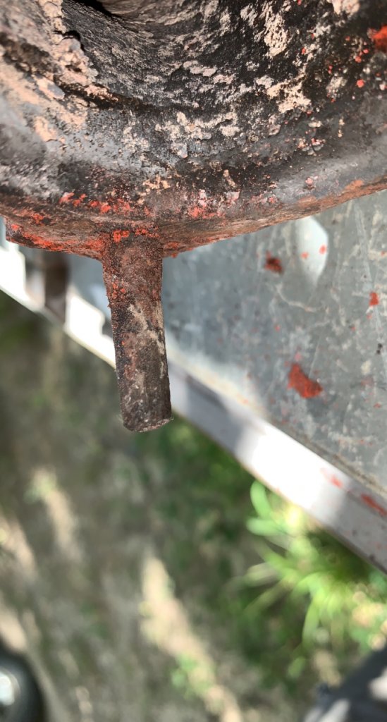

It dieseled before I switched, I just switched yesterday I think? I can’t remember hardly anything. I switched because someone said my issue with a hiccup when quickly accelerating was my vacuum advance being on manifold instead of ported. I honestly don’t care what it’s on the truck runs fine on either I just have to tweak the mixture screws. The truck idles at 18-20 vacuum majority of the time. Sometimes it stumbles and idles at 14/15 that’s when my intermittent vacuum leak is around. I’ll run some carbon stuff through tomorrow and check the temps with my infrared thermometer. I just took the manifold off and threaded the stud part and put rtv all over the joint snugged it and gotta wait about 40 more minutes to tighten it down. I would’ve went and got a gasket but the lip on the exhaust pipe is cracked about half way around and fell off. So I just smothered it with rtv for now to atleast lessen the leak until I can get a different piece welded in.
Ok, you made it sound like your worst dieseling was after you switched to ported, but basically manifold is more resistant to dieseling, but that doesn't mean is can't still happen.
So if you want to save that manifold I'd cut the stud off, and drill and tap the manifold to take a bolt.

I did not cut the stud off and redrill due to the design of there’s not enough meat to make an “ear” on the other side, I threaded it and did put a washer and nut on tho. I’ll find out later if everything ended up sealing. The oil leak doesn’t leave a puddle but the worst spot I noticed was probably 4” diameter overnight. It’s not dumping oil but it’s got a steady drip from somewhere, it’s not low yet I haven’t had to add a quart in the ~80 miles so far. I got two cans of b12 to run through the truck later I did switch back to manifold, the mixture screws are around 1-1/4 out I believe, when I first did the carb forever ago it was 1-1/2 out and I’ve only turned it in some. I plan on eventually getting an AFR gauge of some sort to check the mixture as driving to really get the truck running optimal. I took a photo of my odometer reading the other day when I filled the truck up so I can track my fuel mileage.
