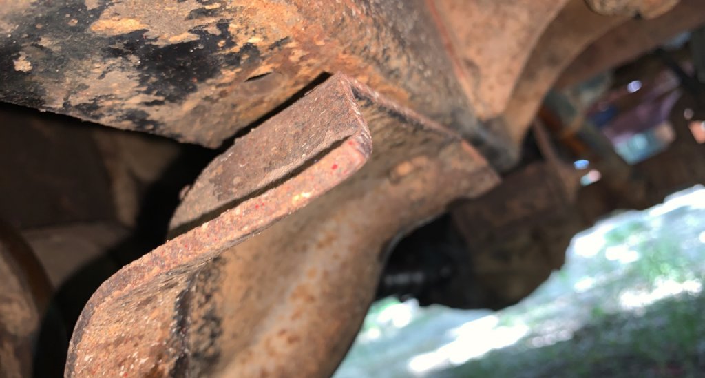

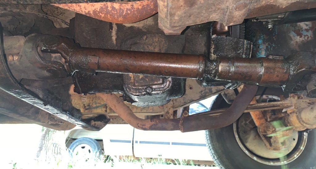

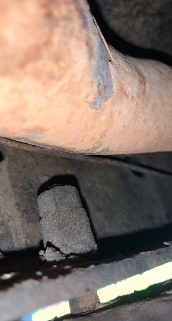

Here’s the transfer case bushing thing. And my oil leak and the spot from an hour of sitting.

As for the other stuff, you need to look to see where the fluid is coming from. First start by cleaning up all the mess under there using whatever method you like. Traditional degreaser or a couple cans of brake clean. Then drive it a bit and you should be able to find it with a visual inspection, if not you can run a die test, but with that much dripping I'm sure you'll see it, you just need to clean up the excess so you can see the source of the leak.
As for the transmission cross member just run the 7/16" grade 8 nuts and bolts, as suggested. I'm not sure what the spacer thing is your taking about, is that the thing above the frame, before the nut. If so those are pretty much superfluous. Just run nuts and bolts. It's more important to replace them with something, before the remaining bolt lets go, than factory correct.

Both, but faster if I’d just shut the truck off, like leaving work for lunch it cranks and fires a little before finally starting. I’ve cleaned the whole engine bay and under the truck except for that tcase cross meme we. The oils are coming from rear of engine. I’ll work on getting some bolts in there to replace the missing one. Yes the spacer is what I was calling a bushing.

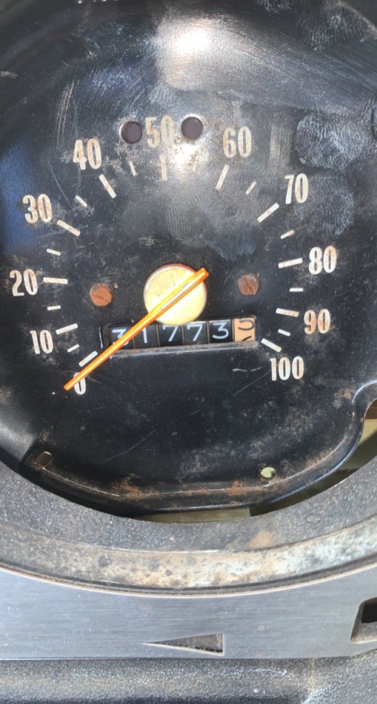

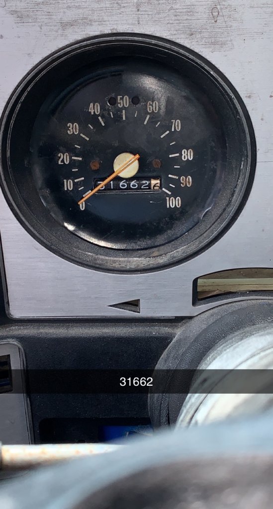

Had to refill on fuel today, got from 31662.55 to 31773.55 (111 miles) by using 13.581 gallons of fuel. Comes to little over 8 mpg, sadly. I was really aiming for ten lol.

you probably already know this but a lot can affect your mileage. Overdrive, manual vs, auto and rear end gearing as well as your right foot. I've had my truck for 4 going on 5 years. 305, 700R4 with 3.41 rear end. On my commute to the shop I've gotten consistently in the low 11's 11 - 11.2. I have achieved 16 on the highway by driving 55 - 60 and being easy on the skinny pedal, normal highway driving 70 - 75 and stepping on it to keep up with traffic 14MPG. Tow the big trailer with load and it's 6MPG. During the winter I replaced the intake manifold gasket and got the vacuum advance working. My last 2 fills (4 tanks) I've hit 14 on my commute now, and last time I towed the trailer was 9.6, no long highway trips empty yet so I don't know.
Your combination will likely yield lower mileage than mine, my point kind is we have questioned your intake, and that well could have a negative effect on your mileage as could anything else that is not right with how it runs. If it's a SBC engine you should see at least 10mpg, unless you really like pushing on the skinny pedal or have a low ratio rear end and like to drive high speeds a lot I agree that you should be able to see 10 at minimum.
