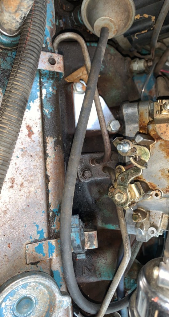

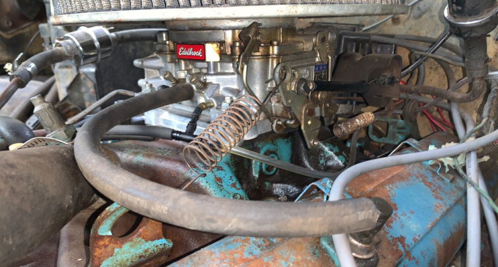

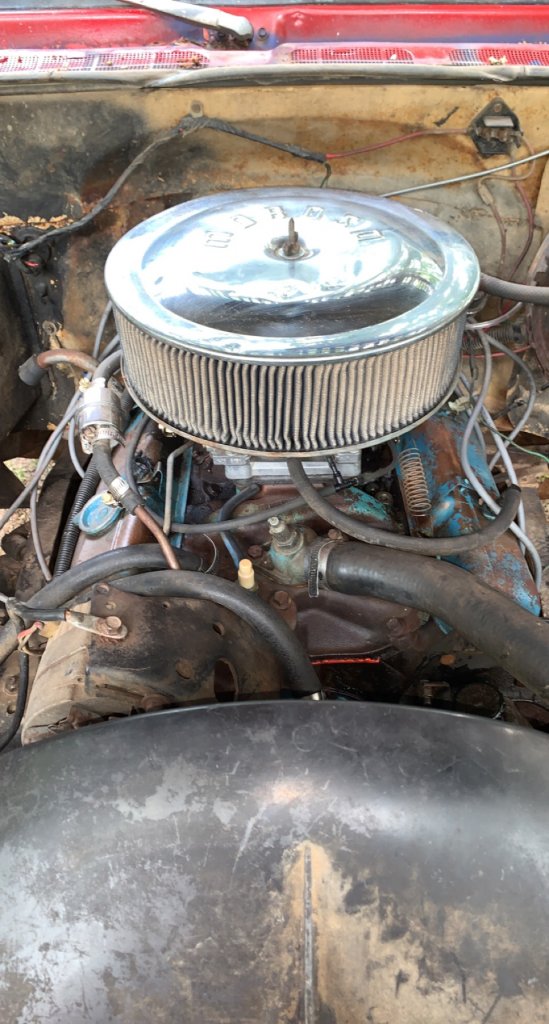

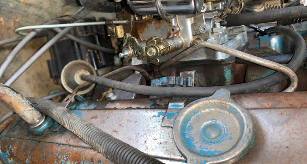

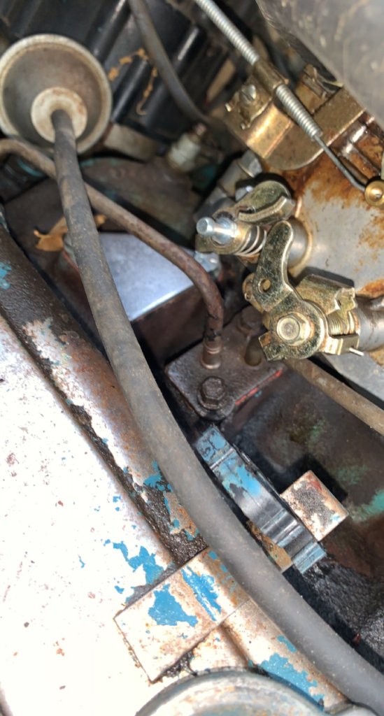

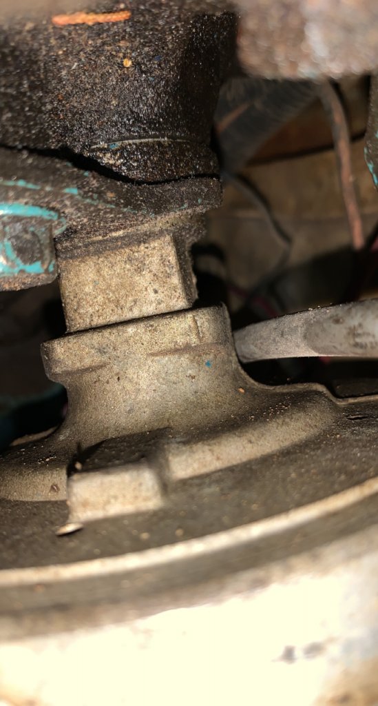

Here’s photos of around engine bay, one of them is the distributor hold down slightly oily. As @AuroraGirl mentioned the linkage, there is no play in any of the linkages.

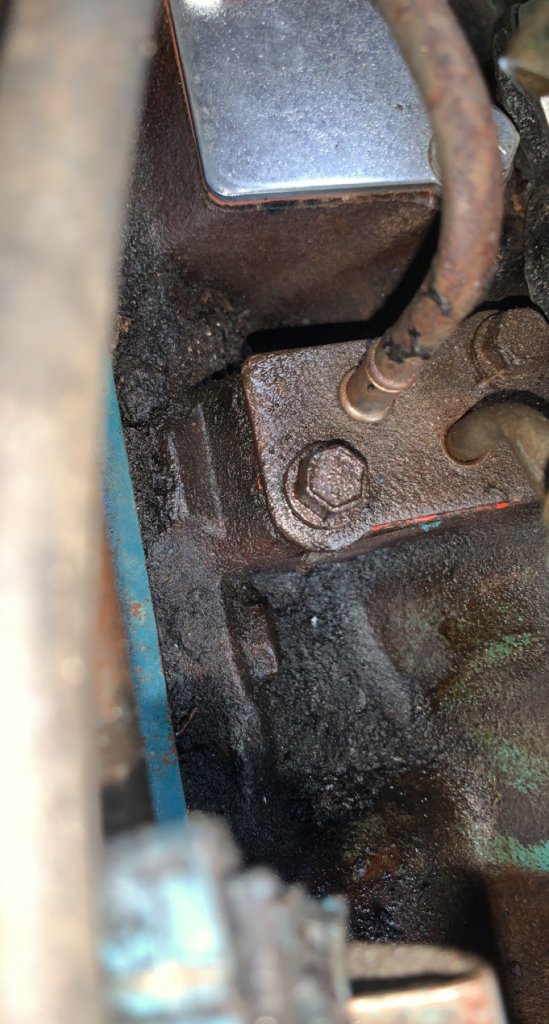

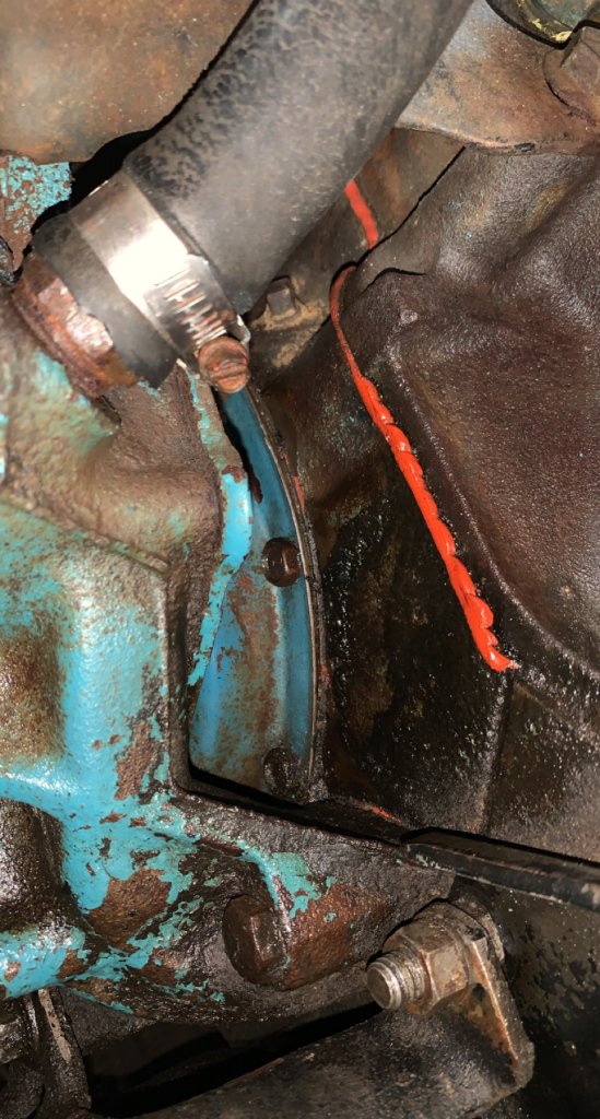

Here’s the rtv all over the front China wall, and the second and third photos I have no idea what that plate is,also held on with rtv, or what it does. It has two metal tubes coming off that I’ve put vacuum caps on the ends of.

Sorry for later response, just got home from work. I would’ve left the egr if I didn’t have the edelbrock. They didn’t go together without an adapter or block off plate and one cost 10x the other so you see what I chose. I just got home from work and I was sitting in the truck idling for a second then I revved just to hear the exhaust again and let it lower the rpms and shut it off and it kinda sorta dieseled? A little? It’s like it turned over twice again after it shut off. The truck shook like crazy. I’m also noticing once warm the oil pressure is low at idle. The gauge shows 0,60 and something else I dunno it doesn’t get that high. It’s usually 60 after first start and around 60 when in the throttle but at idle after it’s warm it’s closer to 30/35. I think I remember reading something about 25 is the lowest you should run a 350 but the 30-35 is concerning me. The truck does have an odd smell, my sister described as pinto beans. I’m hoping it’s just the jb weld I’d got on the exhaust? I’m not real sure tho. If you have any questions or concerns about the truck being warm please ask. I don’t need performance from this truck just need reliability.
The item in your pictures with the two tubes is for a "hot air" choke. Those two tubes connect together and just make a loop that passes down into the intake in the heat crossover passage. Sometimes they get rusted out inside there and it then makes a hole into the exhaust crossover. If you pull those tubes and don't feel any pressure coming out of them with the engine running you can just leave them out. Honestly, I'd probably just change the intake manifold gaskets and put some thread sealant on the intake bolts. The intake gaskets are cheap and it is a pretty easy job. Bonus is you'll get to see what kind of condition the inside of the motor is in.

a new filter may help.. it looks wet and dirty..(joke in there somewhere)
Jay I feel like this is all going to be deja vu because I probably said these things.....
your throttle cable is ****** up, you need a new one. your cable is broken and that little wire I feel like is a recipe for delayed throttle because you have ot pull the slack out of the cable before it starts moving and its not going to stay linear if you let off etc
Return springs. go to autostore, they sell the factory 2 spring set on the shelf. Use those springs where your rear spring is and cut out the front one.
are those vacuum lines off carb (all of them) rated for their purpose
They make hose for vac advance you should use that hose on the parts you have (fish tank tubing?) You should replace the old one you have becuase its old anyway, you should have a PCV rated hose on the PCV to carb. is that a Fuel line or PCV hose? If you take that exact line into the auto store, you can have them cut a same size piece of PCV hose(Wont collapse, yours looks like it may do that in the bend)
your bend is good tho
B
ut I see your statement about bandaids. Okay. Did you see the powerblast plate thing?
I am confident with a return line, power blast plate, some vacuum hoses, and the vacuum fitting behind carb(Do you not have your transmission modulator hooked up?) you will prob see a good boost of driveability increase
