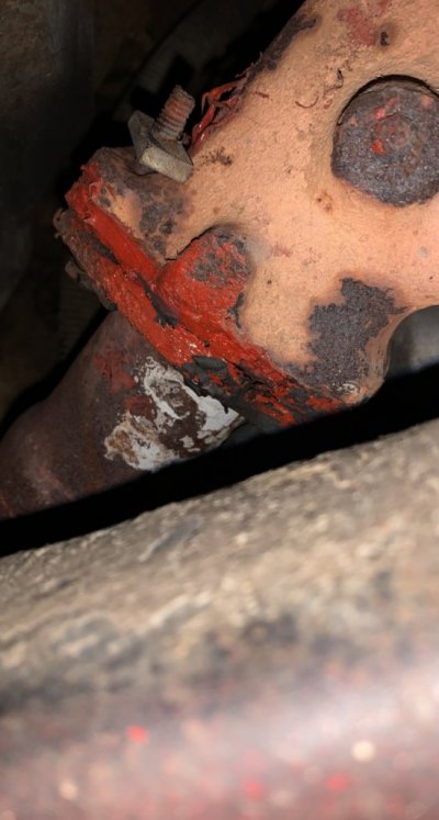

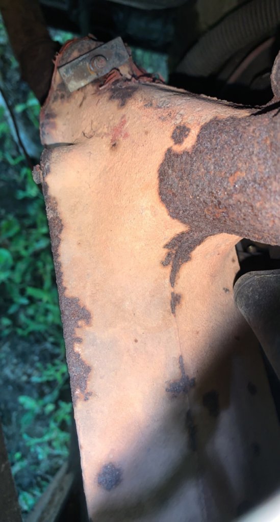

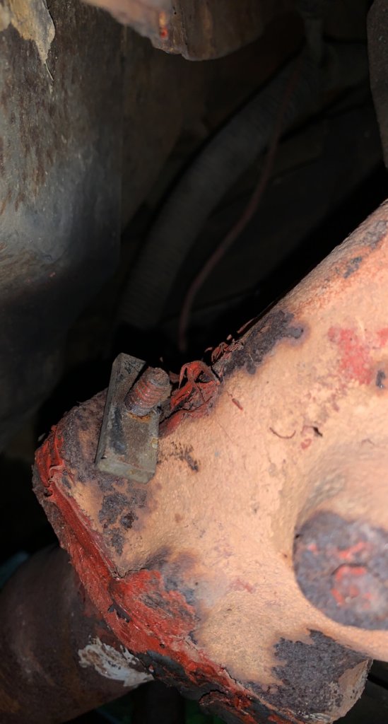

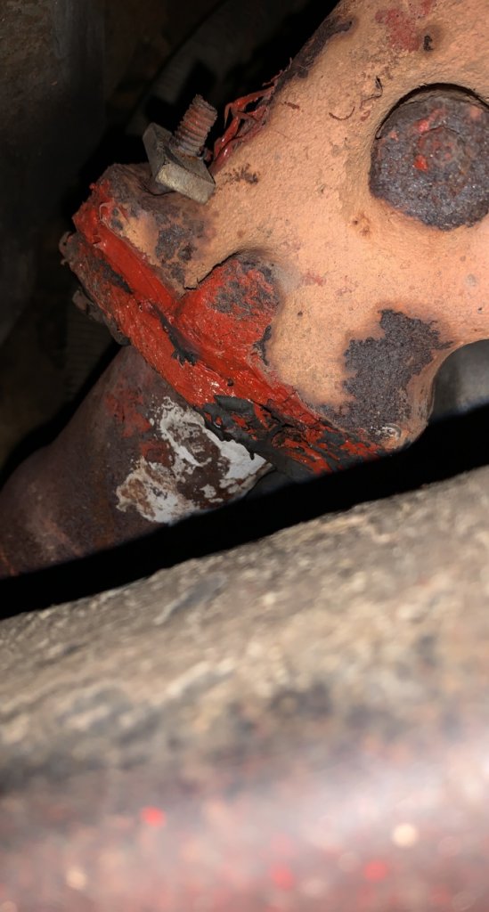

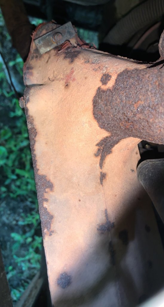

Here’s the exhaust joint, I took it all apart smothered it with red rtv stuck it all back together tightened it next morning left it alone rest of day and then it went fine until the 1/3 of it that doesn’t get clamped blew out and now it has a leak again. 2/3 of them have the bolt going through with a rectangular piece of metal as shown in photos. The third is just a rod coming off the manifold that goes through the plate on tailpipe side. No threads. The other photo is the current pcv, how it was when I got it. The last photo is just an overview of the engine bay.

That looks like one of the newer TBI style manifolds. A replacement manifold can be had for pretty cheap and it comes with the studs and proper donut gasket. You can also try to just put the correct donut gasket in and see if it seals... they are just a few dollars at any big box parts store.

So it's kind of hard for me to make out the details on the exhaust, but in my opinion other than sometimes on exhaust manifold to cylinder heads my personal opinion on red RTV is that it's useless. The only right solution is cleaning up the surfaces, or if they are really bad replacing the down pipe and manifold. That rod with no threads I'm thinking is a stripped out stud.
However I know you don't wanna do any of that. You could try smearing all the sealing surfaces with a product called acousti seal. It's a thick black sticky substance that will seal and take high heat on an exhaust and still has some flexibility. The trouble is nearly no one stocks it anymore, so most counter guys don't have a clue what it is. The Walker PN# 35959, and I can't image that there is any parts store that can't order it. But wear rubber gloves or it'll be on your hands for few days.
https://www.amazon.com/dp/B000C17GOK/
I agree this would be the best solution and proper repair.

There’s no way of me getting all the rtv and junk off of it. I used red rtv on the exhaust to cylinder head too in the middle since one of them leaked as well. It is sealed now. Is it possible if it’s a stripped stud to thread it and put on a nut? No one ever commented whether stock manifolds or headers were better, I just want simple unbolt and swap. The rest of the exhaust is junk so I’m not concerned about having to change some of it.
You could certainly try to thread it. The success will depend on how much rust is on the stud.
My answer to headers vs stock manifolds, is it depends on what you want. If you want reliability, there is nothing better than the stock cast iron manifolds. There is a reason they used those heavy cast iron manifolds, they last and last and seal up well when in good condition, and if they warp they can be easily resurfaced on a belt sander. Headers flow better, but they are prone to leaking, cracking and releasing a ton of heat into the engine compartment. Because of the design there can be heat issues with the starter, fuel pump and or ignition wires. Obviously better quality headers will tend to have fewer of these issues.
To me on a stock or near stock engine headers just don't return enough to make them worth while. On a built up engine that needs added flow then yes they might help. On a daily drive or work truck I'd want the stocker manifolds for reliability.
No one size fits all answer, you decide what is best, but that is my best advice.

Are the manifolds something you can get a pair fairly cheap? I’d do just passenger side but the drivers side looks about like if it ever needed a gasket I wouldn’t know what to do I think it had springs or something another. How do I know whag kind of manifold I have to directly replace it? Or would any manifolds work? I have people that can weld but I’d like to avoid welding as much as possible you know?
I posted a link to the manifold that would be a direct replacement for what you have. $65 shipped directly to your door and it includes the studs/nuts, manifold gasket, and donut gasket. It's a dorman part number, so it is most likely also available at your local parts store under that same part number for a bit more money. Headers are going to be WAY more trouble and require a lot more work to get them to fit. They are not a direct replacement in any way and will require cutting/welding the exhaust.

I’ll look at that and compare to the one I have, I have other 350’s and I even took a manifold off one last night but it looks completely different.
