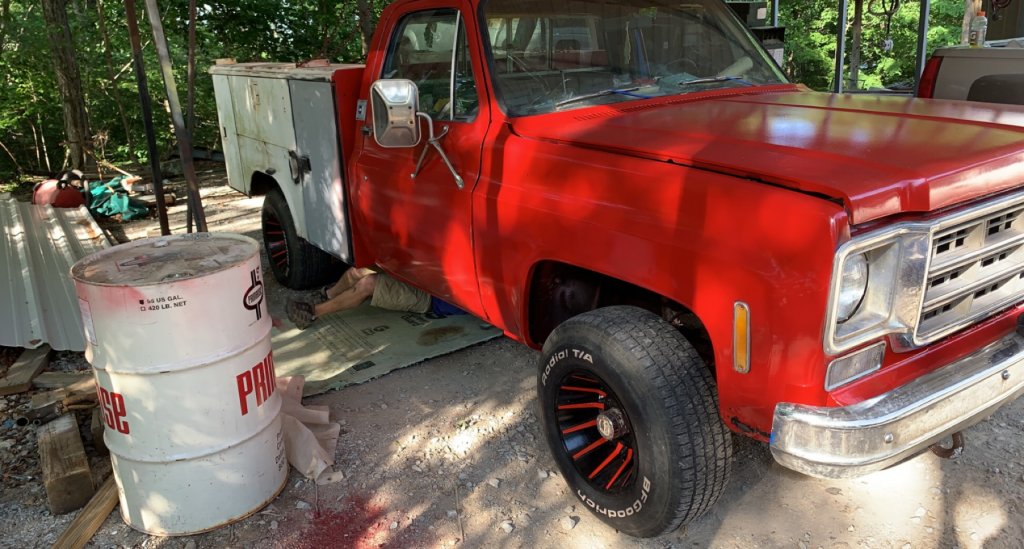

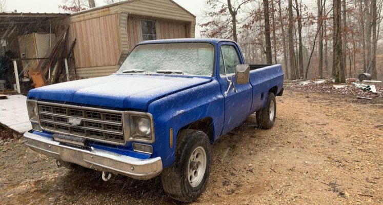

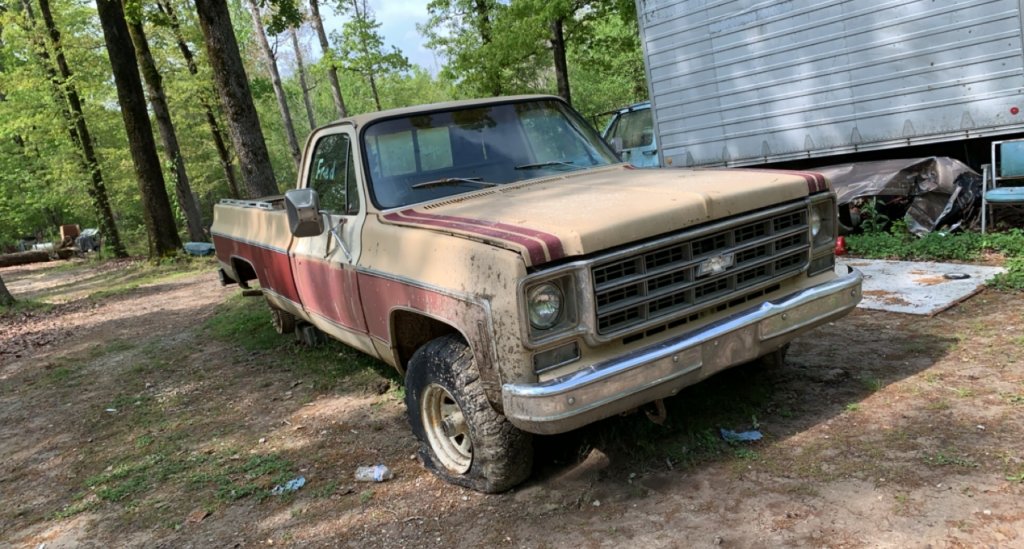

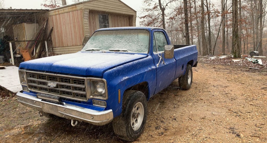

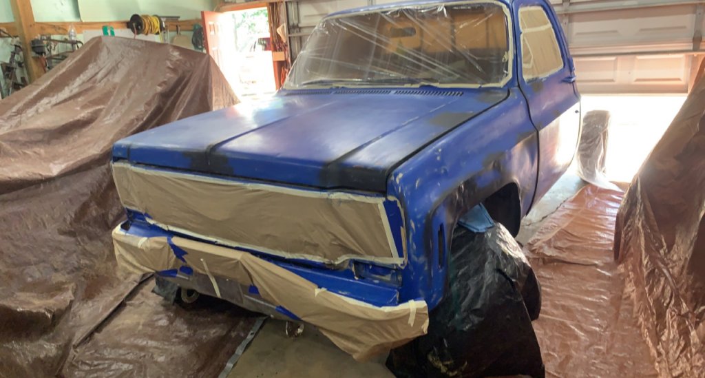

Here’s some photos of the journey of this truck lol
