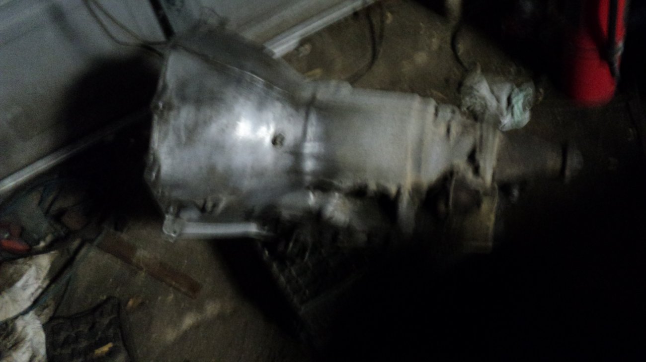

Got the th-350C out today.

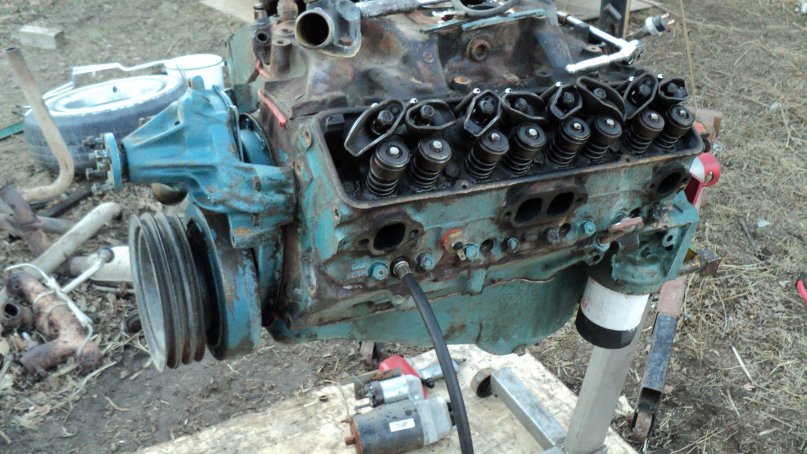

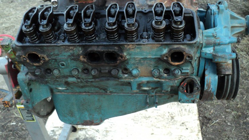

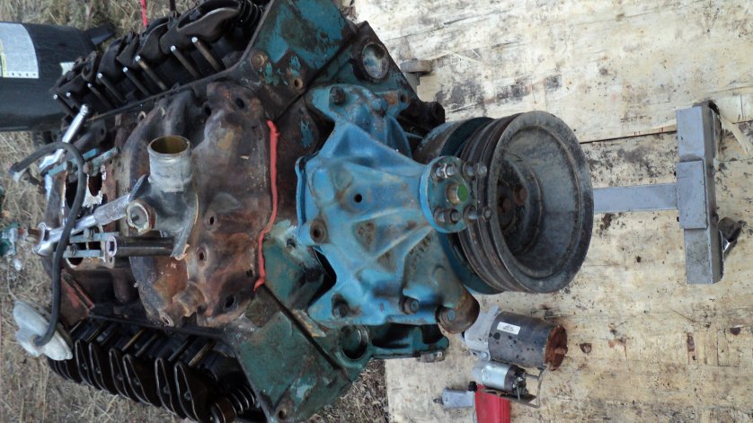

Pic update:
The tranny picture was when i was scraping it, i hadnt washed it yet.

Well i got some work done on the engine today and.......... Its been gone thrue befor. I first noticed it cause the rods/caps were numbered when i pulled the pan off. So then i got ancy and had to pull a head, and to my surprise i have .030 over flat tops. So using summits compression calculator i should now be at 10.5:1 compression instead of the 9.5:1 that i figured. Theres no lip at the top of the cylinder from wear, and theres hardly any deck height. Honestly the deck height is about equal to the height of the head gasket. So now knowing that, It will have more pep than originally planned, and i think the cam with LOVE this compression more.
Sorry for no pics, it was dark by the time i came inside.
