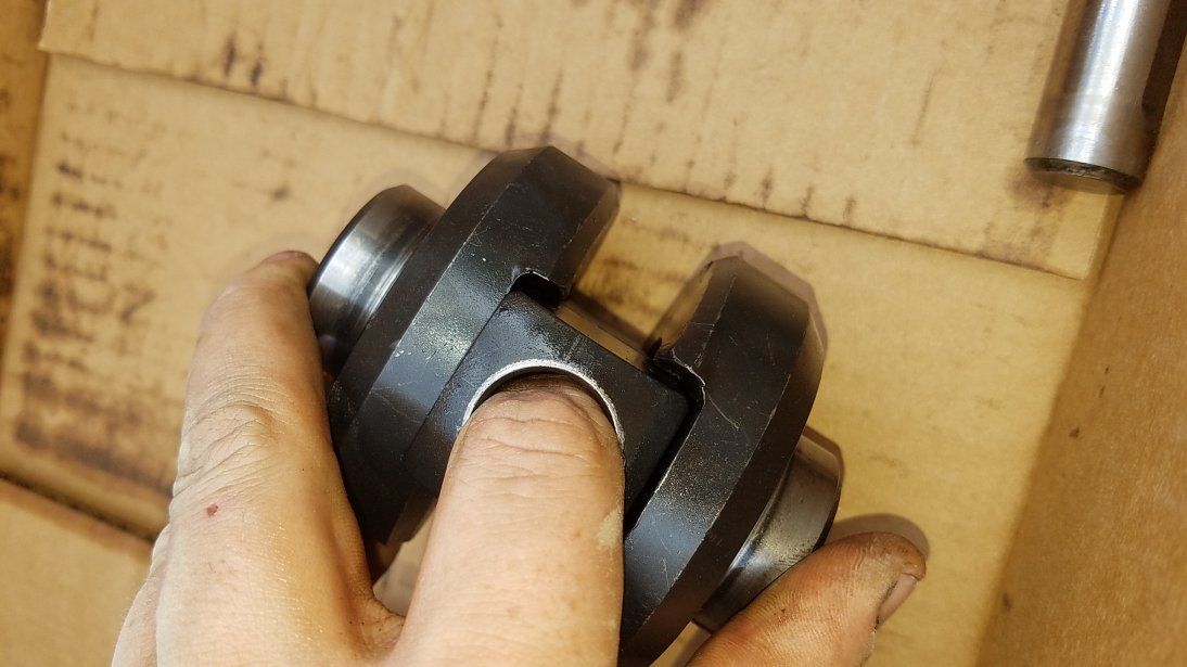

Fuel: This has been kicking my ass all summer. Spring time my electric was doing just fine, but when It actually started to warm up, it would have issues pulling fuel through the sending unit to the pump. Couldn't keep the bowls filled under throttle *3k+*. So until I get my new tank sumped, I just stuck a mechanical back on it for the time being. A few days later the car was at a secluded road with others, and it would just plain cut out*roughly 8th* and I could tell that the bowls wernt filling. Well I had just driven 50ish miles on a hot day, so I figured heat might have had a role in it. well it did it many weeks and months after.... Eventually it got so bad it would just do it driving down the highway... The pump was under warrenty, so I had them get me one.
Went to put it in and the arm/spring/pin just fell out of the block.... There was my issue. The casting around the pin broke and the arm was just floating around in the housing barely pumping fuel. Issue fixed.

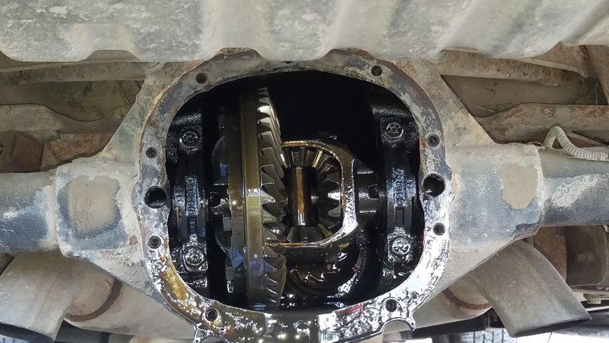

Up until now she was open, when I could plant the weight right, she would spin both, but if the bags were low or I was on a grade, just 1 mark.
This didn't help at all when the light would go and you spin half track....
So this weekend I finally went and picked up a second hand spool that will last atleast until winter *came out of a n2o car, hence the stress marks* . I'm currently gathering parts for a 9".
It launches soo much better, but its a PITA to turn now lol, it feels like theres a cob up its rear.

But back in February we found the limits in the stock housing with the new traction, so i ordered a new rearend minus housing, i had a local shop do the housing work.
I got it all in the mail then assembled it
35 spline, 1200hp capable each
Full spool life
Full aluminum center section
4.56's
