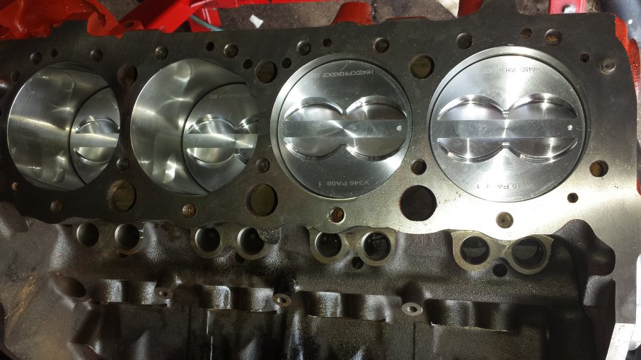

Thanks. I did it all myself.
It's a deck plate. It basically preloads the block when you bore it. The metalergy inside the block thinks the heads are bolted on. So when you bolt the heads on its perfectly straight.
Deck plate vs. Non it's not a whole lot of difference. But I think it's like .001-.002 out of round if not used.
And I wanted it PERFECT.
And for those who are following this. I actually went .031 instead of. 030. Who can tell me why?

You're very close in your description of what a deck plate does. But at least you know what it is. Many don't. When you need precision it's the way to go. You're right in it simulates a head being bolted to the block. You torque the plate down to the same spec you're going to torque your heads. This could be different depending if you're using cast iron heads or aluminum heads. The purpose is so that AFTER a bore job and short block assembly, then you torque your heads down, you pull the tops of the cylinders out of round. The deck plate ensures that your cylinders will stay round from top to bottom even with heads torqued down to spec.
BTW, Hi Performance Olds, A Deck Plate bore job is just about a requirement. SBC don't get out near as much as a Olds with all the head bolts and the size of them.

Basically what I said. We just word things differently. And I was alot more vague.

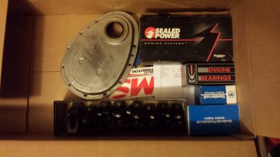

And I got more parts

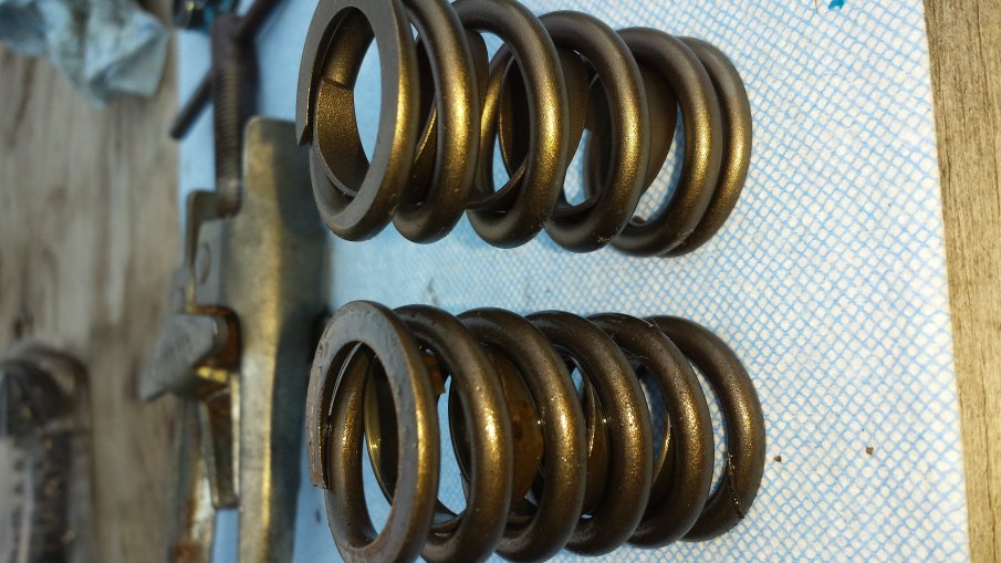

New springs arnt exactly what I ordered.....
The one with less coils are the new

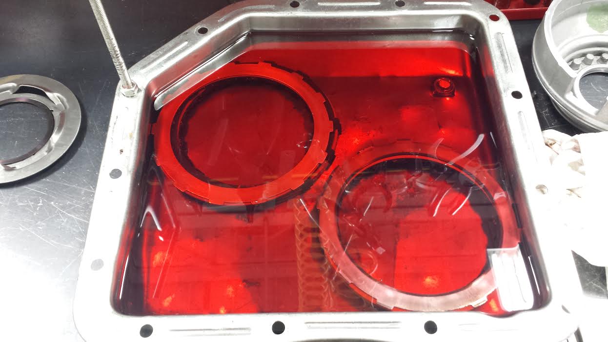

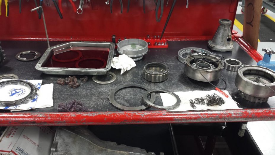

A few pics of the trans build. I didnt take many, but I will get one of the trans tomorrow.
Thats type F if anyone would like to know.
