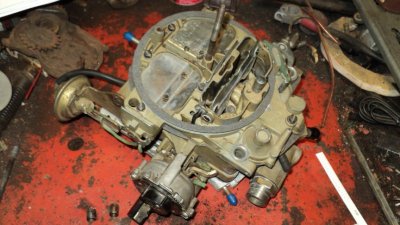

Lol, more bad news.....
Went outside and set it back on the ground(since i put the new crossmember in)
And went to start it and it wouldnt idle worth a ****. It was like it was choked out all the time. So i popped the hood and took off the air cleaner, and my intake has gas puddled on both sides. After closer inspection, my gasket is weeping between the mainbody and the lower butterfly body. So now its time for a rebuild.
I already had a carb kit on hand that i was planning on putting in my truck, but since Ive found no reason to yet, ive decided im gonna put it in the monte.
Well the monte currently had a carb that had the computer plug on the top, it didnt change the way it ran, it was just there. So now i had to find a carb that fit the kit i had. SO i went outside and found a 17057204 thats gonna be gettign a rebuild and then going on the monte.
And theres gonna be some parts swapped(choke, and misc.)
Driver4r
Jun 21, 2012
3,087
41
Nebraska
Trevor
76,74
k10,c20

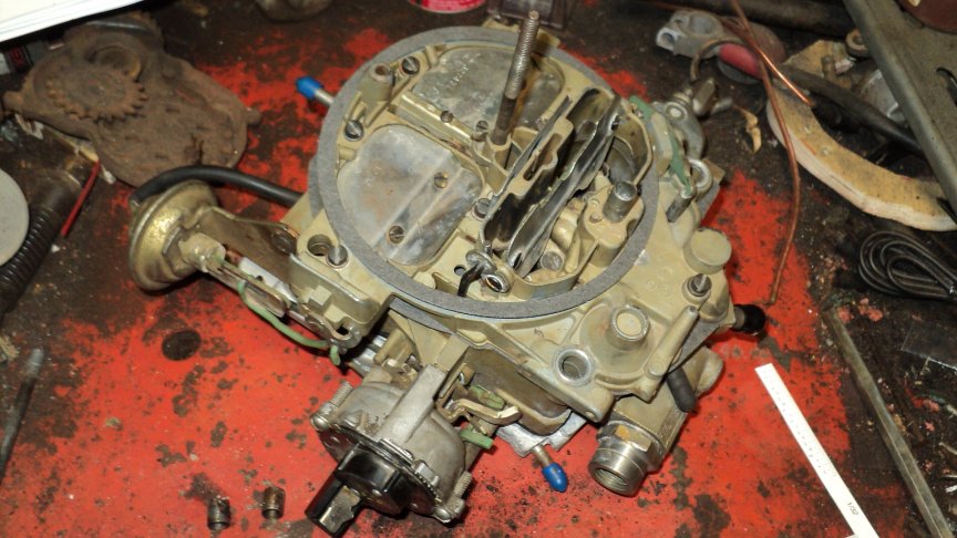

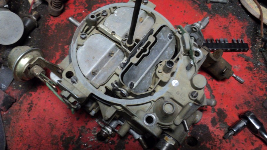

Well, i ended up going with a 17059206 instead.

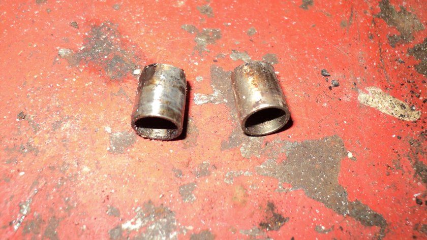

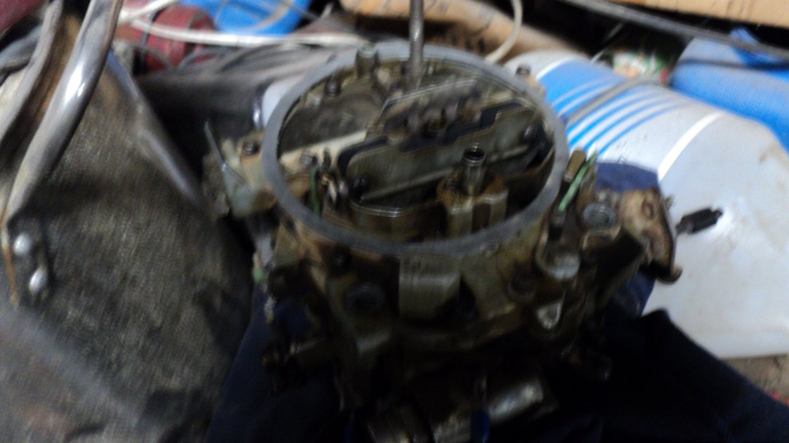

Heres the befor/after. and Old.
Also, first person to guess what these little are gets a cookie.

Duhhh, throttle shaft bushings. No guess needed. Hope you have the correct reamer for those.

eghhhhhh.........no
Wrong answer, Jack
47,859
11,038
hmm, maybe I better look a little closer then. First glance I figured throttle shaft bushings.

Nobody has any Idea???
350runner
Feb 9, 2013
2,858
226
tx
Ceasar
82
Fuel bowl vent blocked,Float sticking or set a lil high
