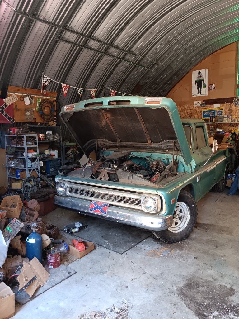

Dixie says she would like to see crusty back on the road again too. These trucks are such a cool part of GM history
14,032
24,154
Thank you Dixie. Dixie looks like a fine truck. If Crusty could be worked on in a garage or shop a lot more would get done on it.
