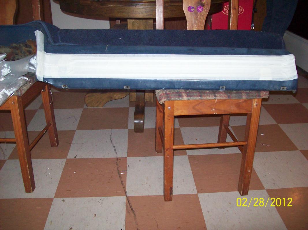

Heres a few pictures of the start of it. I am basically planning on building this in 3 or 4 pieces then ataching them all togather. Like I said first time i have ever done this so hope it works.
First step was to remove the dash, I want to build this so it contours the dash pad perfectly. The only way I could think of to get good results was to actually use the dash as a mold. I do NOT know if it will work or not, but I just masked the dash off where i would be spreading the fiberglass.

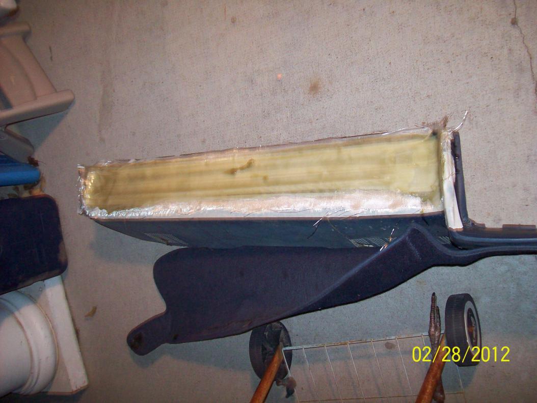

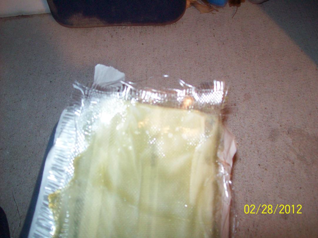

Next I went ahead and mixed up 4 ounzes of fiberglass resin, using a paint brush i smeared it all over the masking tape in the area where the console will be, then i layed 1 piece of fiberglass mat on it and worked it in with my hands, then repeated so there is actually 2 layers of mat.
Here you can see the resin and mat all layed in waiting for it to dry.
