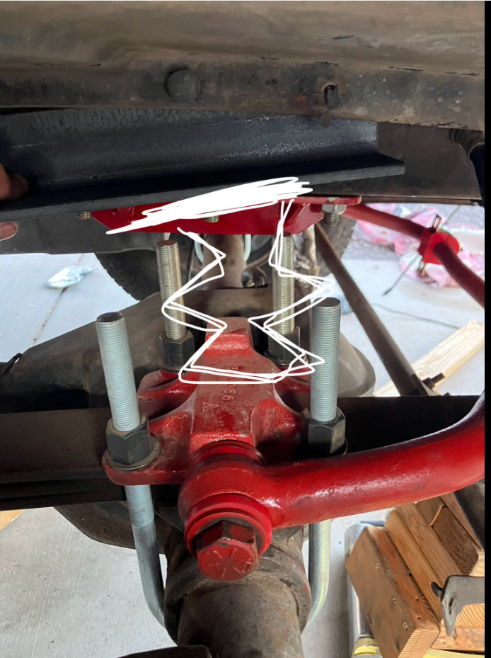

I have been working on a GM Dana 60 swap in my C30 along with a 6.0/6L/NP205 and I have come to the point of bump stops. I am utilizing the ORD high clearance crossmember with a mast motorsports high clearance pan. I actually have great clearance between the pumpkin and the engine crossmemeber. The limiting factor will be the factory leaf spring plate. The trucks is factory high with the 3 leaf front springs.
I was considering using something different for a bump stop, a jounce. Here is the one I like from the 2500 Suburbans:
I thought it would add a level of damping to the suspension since these leafs tend to ride hard. Any thoughts?

If you're hitting the bump stops you need more suspension lift. You don't want to ride on a bump stop all the time, it'll be way more rough. The stop will act as your suspension and it won't do very good lol
Cut down the u bolts too. Can't say that would bottom out though. Wouldn't need much more lift at all

The factory K30 suspension doesn't give much travel. The jounces are meant to be used.
I have not cut down the u bolts yet because I am unsure if I will get the custom ORD springs yet. I will before I run it. Thank you!

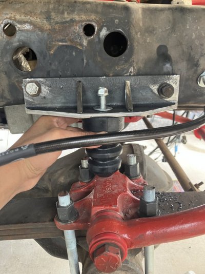

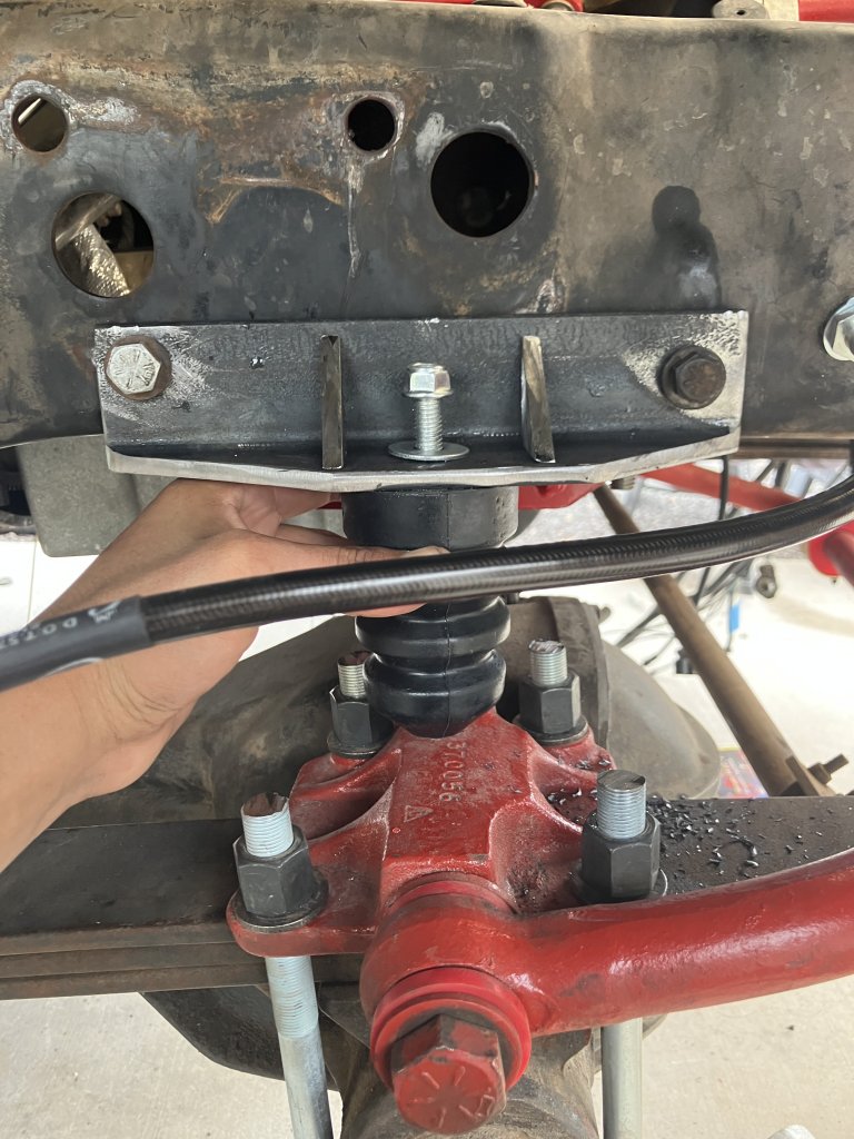

Well I started making the bump stops. I called ORD and the guy I spoke with thought it was a fine idea.
