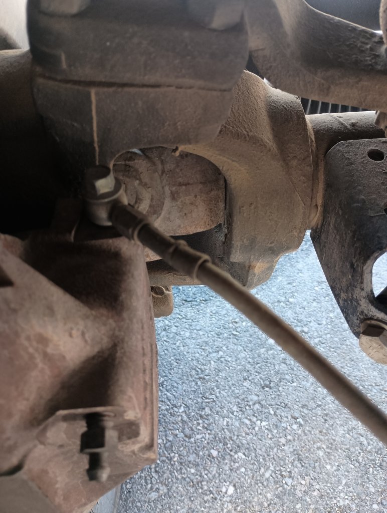

I just looked at my Blazer and my hoses are straight and it looks like having a 90° bend at the caliper would complicate things.

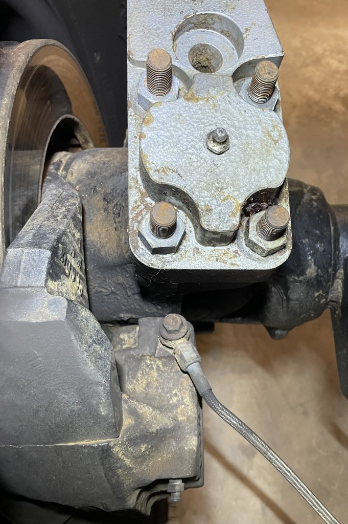

Nothing on either one of the hoses comes apart. This is my crown hose on the left and what I took off the Dana 60 when I got it originally on the right.

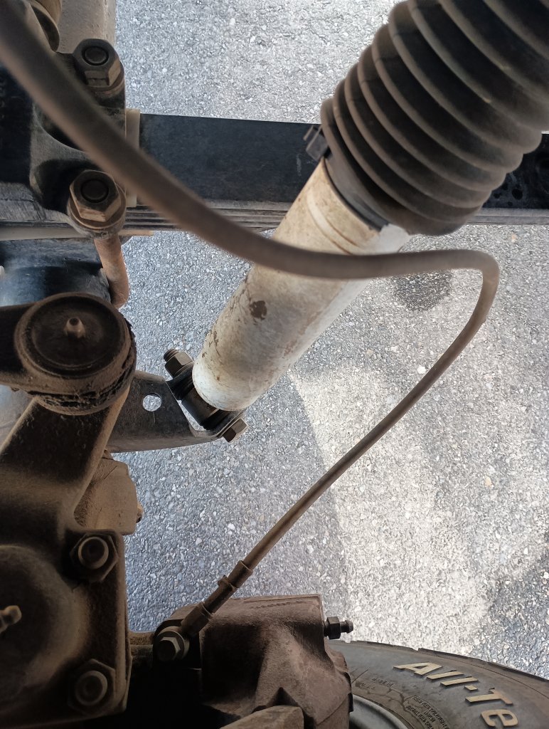

My 60. Personal choice but I use adapters and standard AN easy to source hoses on everything. Your Crown hose should work just fine. I agree with John, a 90 on the end would seem less desirable.
