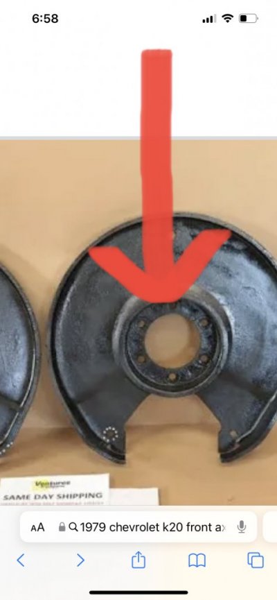

I was under the impression the 44 and GM 10 were the same from the knuckle out….I love the Dana 44 but the backing plates on them are not as good as the GM Corporate. The last 44 I fixed I actually used the plates from the Corporate axle. They are much more sturdy.
HS
I found out the hard way that the brake calipers are not the same. Not sure what else.I was under the impression the 44 and GM 10 were the same from the knuckle out….
Is that not correct?
The spindles carry different wheel bearings. You can use everything from the knuckle out on either axle, but I'd keep track of what's used to make it easy for replacement parts in the future. I like the solid backers on corporate axles but like the strength of Dana internals & axle shafts because they've never broken. I've busted spider gears, stripped splines & burned up many wheel bearings on corporate diffs.I was under the impression the 44 and GM 10 were the same from the knuckle out….
The calipers I purchased for the 10 bolt didn't fit on the rotors/backing plate of the D44. Barely different, but would not sit down on the rotor enough to put the caliper pins/bolts through the holes completely. The calipers for the D44 fit perfectly first try however.What was different? The hose connections and piston size? That's a year and brake option difference, not D44/10bolt difference.
It might work that way, but not work the other way around? I tried 10 bolt calipers on D44 with no successMight have been a replacement caliper issue. I've used calipers from a D44 on a 10 bolt at least once that I can remember.
