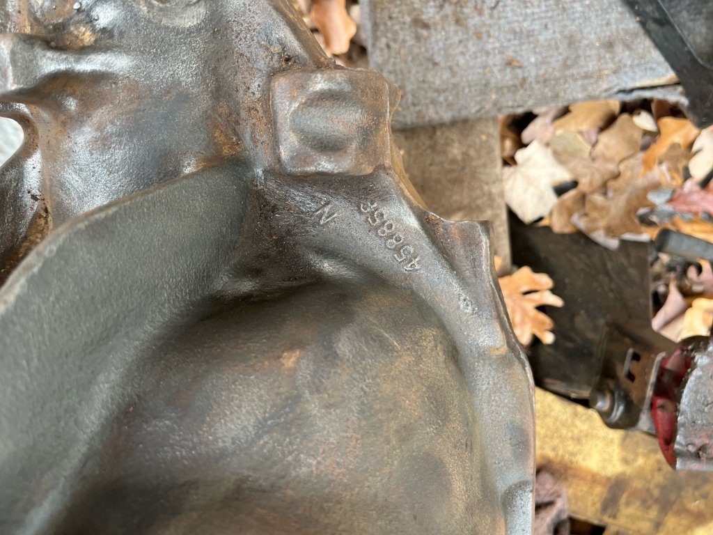

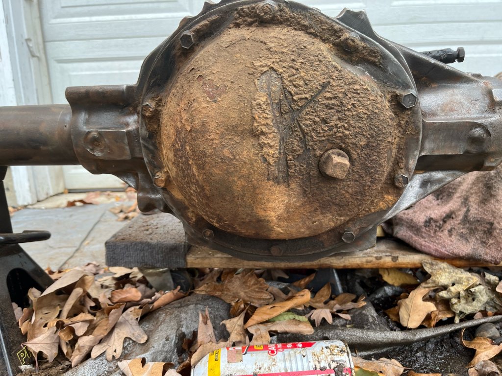

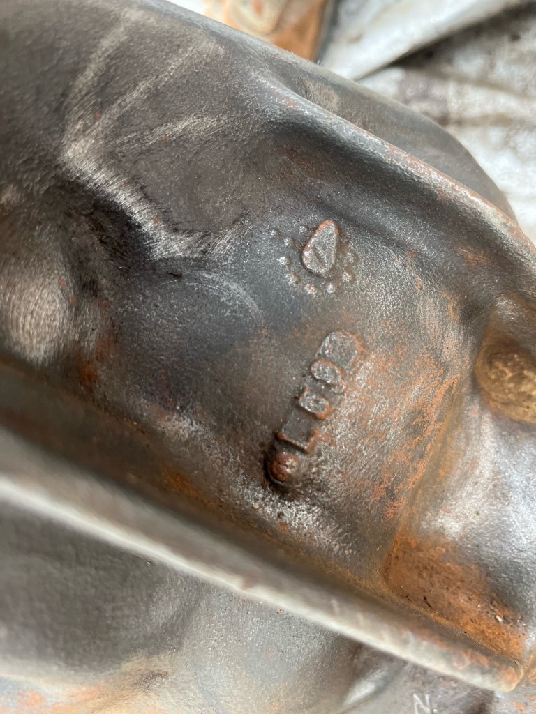

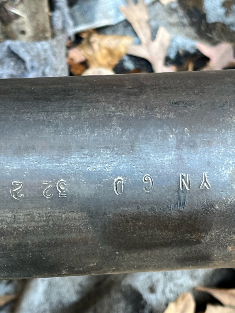

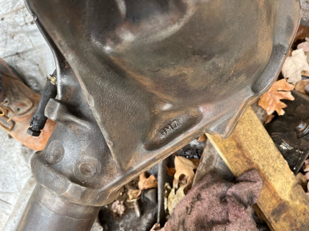

Can Anybody help me determine just what I have
I have a 79 K 20 and need oil seal and yolk for the front Differential
So far all ive seen is that its a Dana 44 but so far the oil seal does not fit and I need a new yolk and am being told about 50/50 that the 8091 fits and the 3581 fits but other places say they don't
I have the strap and bolt type connection and the seal guard is as big as the hog nose on the diff
The only number/letters I can find on it, on the long tube are
YN G D 32 2
Thanks in Advance

Show some pictures of what you are working on, please.

Pictures. Of the cover mainly
A 79 can have either a 44 or a 10 bolt. My 79 has a factory 44
YN G D 32 2

That's a GM 10 bolt corporate.
