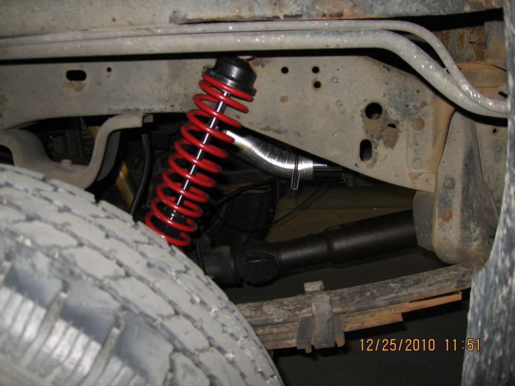

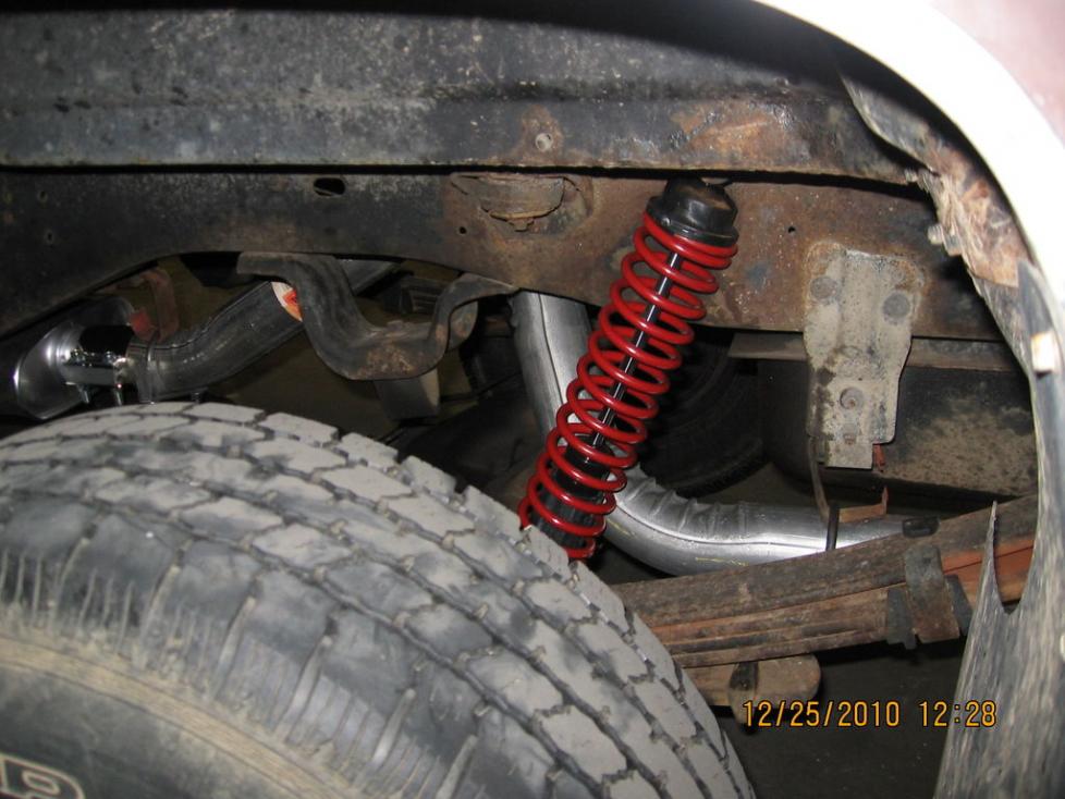

Here is pics of my rear shock mounting areas of the frame, but being a Burb I am not sure if it would be different or not from a P/U frame as fare as factory holes in it.
Pass side:
attachment.php
Driver's side:
attachment.php

The cracked hole is something someone drilled, the shock appears to be in the factory hole. Because of the unusual shape of the spot I'd try to get a small section of identical frame from another pick up and weld onto the inside of the rail.
Fwiw, pick ups and sub frames are different as well as the shock mounts for each.
