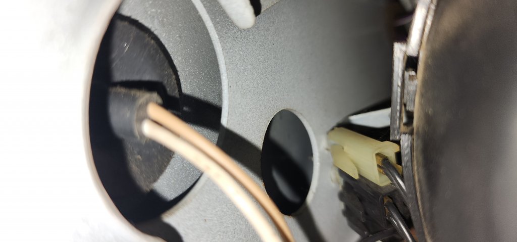

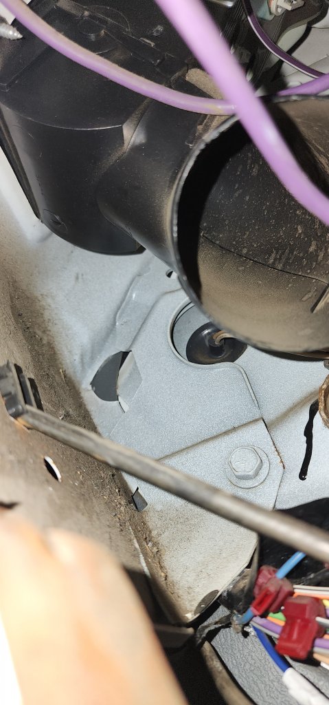

SquirlyDan
Nov 28, 2024
WI
Idell
V2500 Suburban
5.7L
I removed the grey plastic thing, wasn't much help unfortunately. They don't appear to be coming in with the rest of the door wire harness. This grommet seems to be where they're coming in from.
