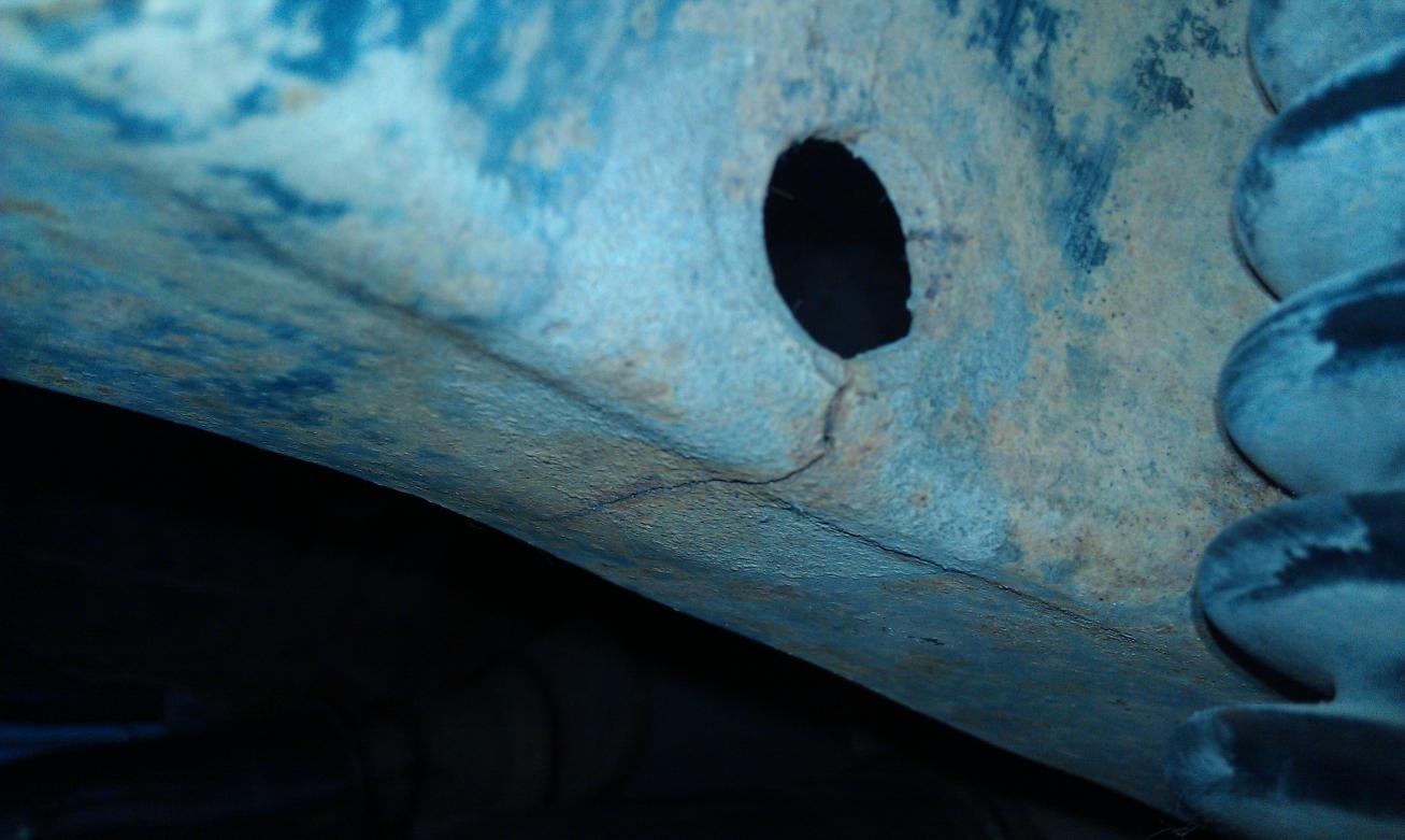

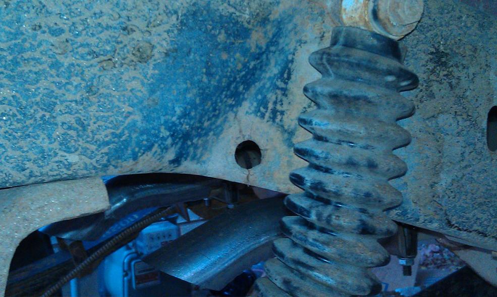

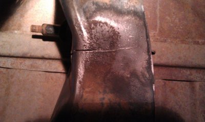

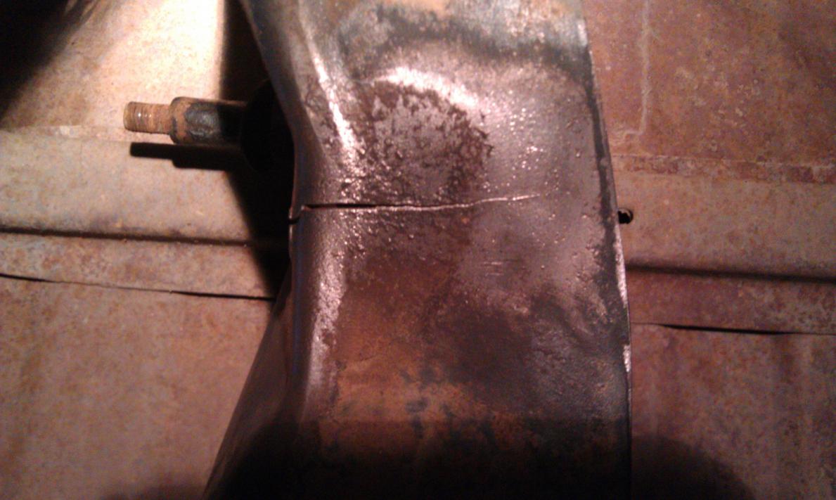

Here are the pics of the crack

That's in a tough spot if you wanted to plate the side, you would have to try to make it work around the shock mount and still have clearance for the shock. You should wire wheel the crack up the side of the frame and see how far it travelled. You should also look inside the frame and see if there is a better option of plating it there (doubt it but you might be able to work around the wiring). A plate on the bottom will be a must too, following the contour of the frame.

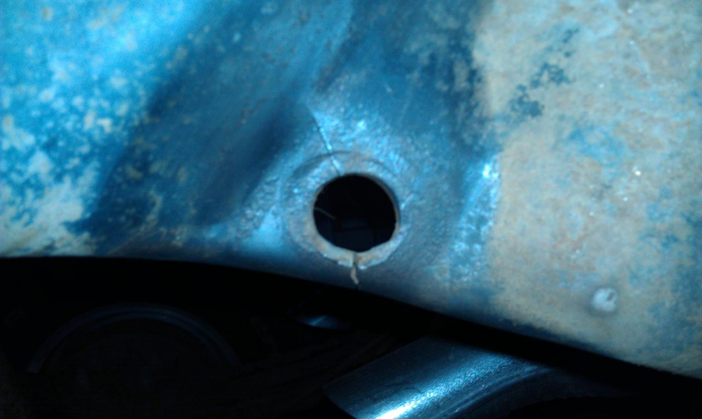

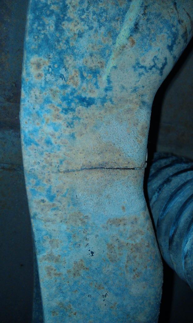

the crack goes about an inch above the hole and goes all the way across the bottom except for about a half inch
