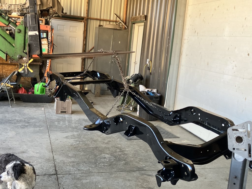

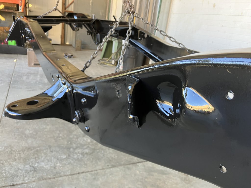

On my 79, I had the frame blasted as a unit, as having it be a roller was important at the time, then I disassembled it, cleaned the remaining areas with a purple 3m wheel, then painted and reassembled.
If you look at my 79 thread in my signature, starting at post 495 shows that process.

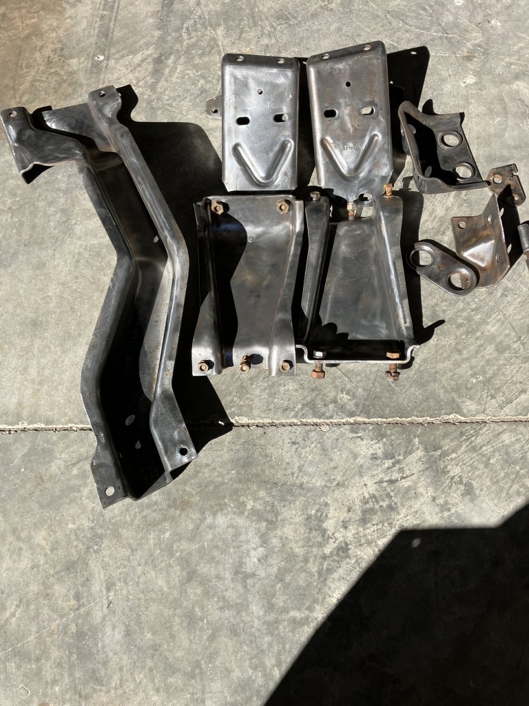

Lego, on your second pic from the top, what are those two plates on the floor? I see them bolted on in your top pic. Are those just for lifting? Thanks.
legopnuematic
Licensed Junk Dealer
Oct 27, 2016
3,396
9,839
MO
Spencer
Brackets for a tow bar I made when I flat towed the truck once.
