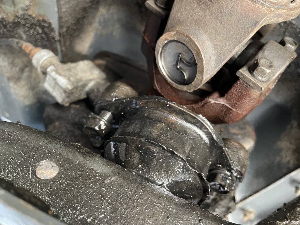

So just as some of you suspected we had a loose transmission mount. Hooray!!! Or so I thought. Took it for a test drive and it got worse. The sound of gears grinding singing to me.
Have a video of it and no matter what gear I get in….when I let out on the clutch, grinding gears greet me. Even reverse.
Now I fear the differential is just fine but the transmission may be shot.
Well you can pop the diff cover check the fluid and gears for obvious damage. If there was some way you could get an assistant to help you listen to see if it's coming from under you or behind you that would be helpful to narrow it down some.

I had an assistant. It’s coming from the transmission and it sounds like when someone is grinding the gears except it’s in gear and happens when you let the clutch out

Agreed I just thought popping the cover off the diff to do a quick inspect, would tell him if that's the problem. Looks like he's pretty sure it's coming out of the transmission though.
Gonna check oil levels on both tomorrow. But the new sounds are scaring me for sure.
May also disconnect the drive shaft and put it in gear. That will help eliminate sources of the grinding.
