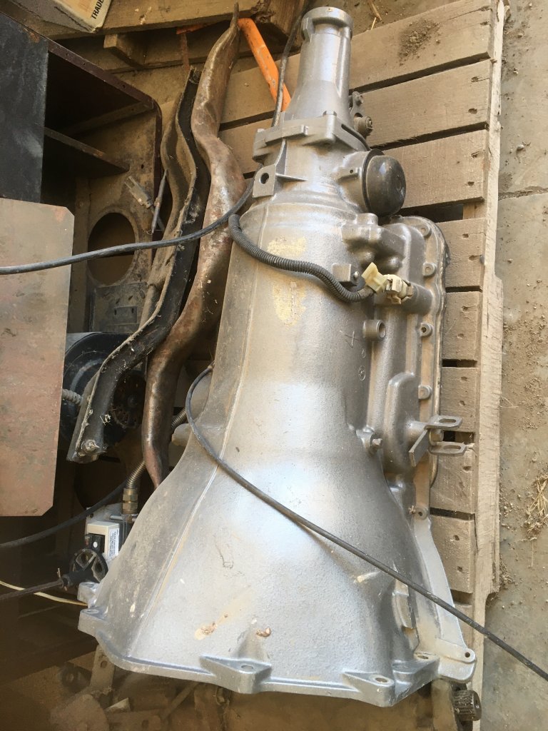

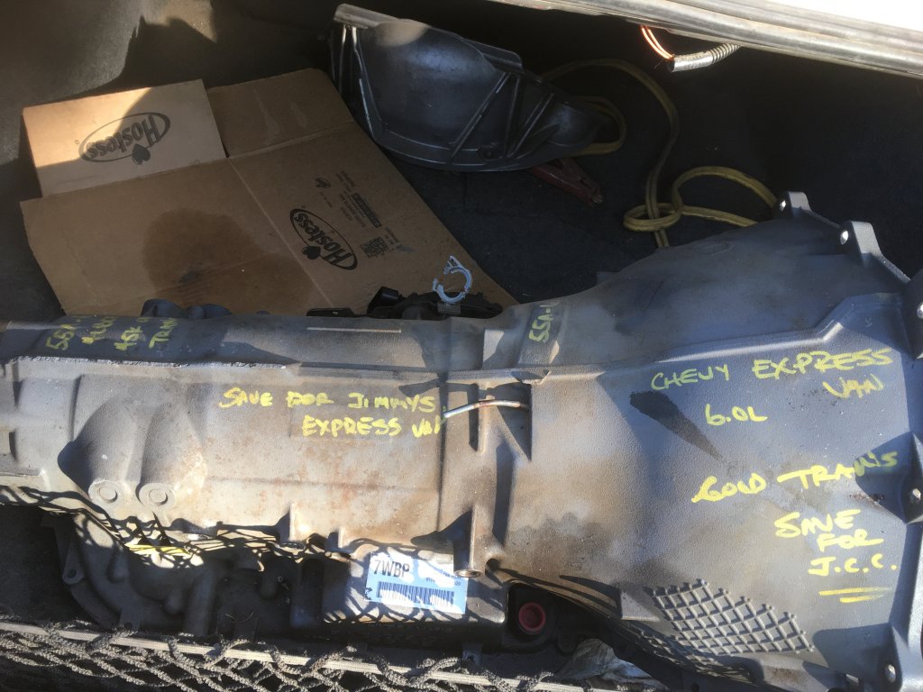

The 700r4 has a I believe 28 spline output shaft, while the 4l80e or 400 have a 30? thats a consideration. T, you gotta get up here, I have 700r4, 4l80e's, and all the stuff that goes into those, like the 205 big bearing input for the 400, (like yours.) I am swapping the C20 dezzle this winter to a 4l80e. It goes down the road at 65 just dandy, but I drive on occasion in Idaho, Nevada, Utah where the speed limit is 80, kinda scary doing 65 when everyone else is doing 85. You spend more time looking in the rearview mirror then ahead, unnerving. Also stated many times 300-3500 rpm is doable, but it puts me on edge more, and it is louder in the cab as well. I bought several 4l80e tranny's for around 500 bucks, low miles, (40000'S). Money's tight, and I like the 4:10 in both the trucks, as I use them as well, er, trucks. Manual trans you need to source all the pedals and linkage, while the auto is cheaper and easier. Come on up and drink a beer one of these days!! Oh yeah, gotta cut your driveline as well, both are longer by a few inches, drill a few holes on trans cross member.
