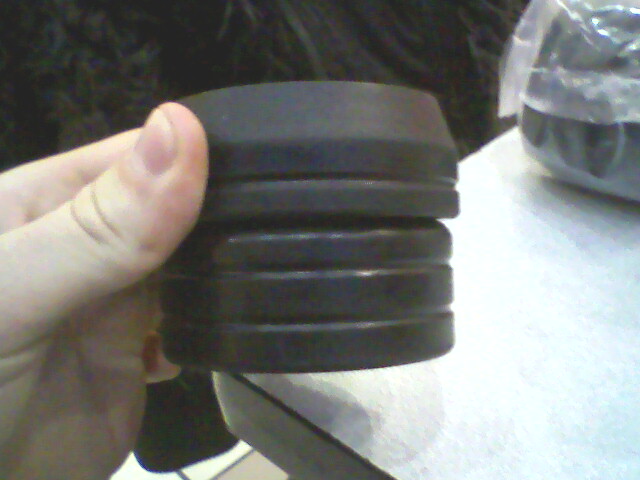

so I picked up six of these bad boys, But I found out there is a top and bottom, I thinking these are the top?

IIRC there is a shoulder on the top one that fits in the hole in the frame bracket part of the mount. Then there is a cone-shaped one that goes under the bracket, with the cone end pointing down. A long bolt with a big washer holds it all in place. So maybe what you have in your hand there in the pic comes apart.
Thats what I thought too I mean I tried but it would not come apart I feel like these arnt the right bushings now

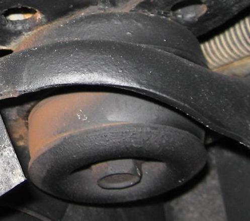

I never saw ribbed body mounts like that. This is a pic of factory style mounts.

I mean I got the part number from energy suspention and everything, but I am still thinking its not the right one
24,924
7,071
Well, if it is aftermarket, it probably will look different. Where did you get them at? Are they a hard plastic, or soft rubber? Is there a metal bushing running through it? If part numbers match up to your application then it should work.....

I got it from a energy suspention dealer, Its grafit im pretty sure, and no metal bushing through the middle
24,924
7,071
That sounds like a body lift kit then to me.
24,924
7,071
That's got to be what it is if that mount in your hand in the pic is one piece. And with those you need to re-use the lower body mount pieces.

I don;t know, I keep looking at that pic and it looks like it should be 2 separate pieces. :think:
What's the part number of that kit?
Usually body mount lift blocks are straight on the sides of them like this:

I see what your getting at, the first thing I thought when I saw the bushings was they must come apart when I get out of work ill give you the part number
