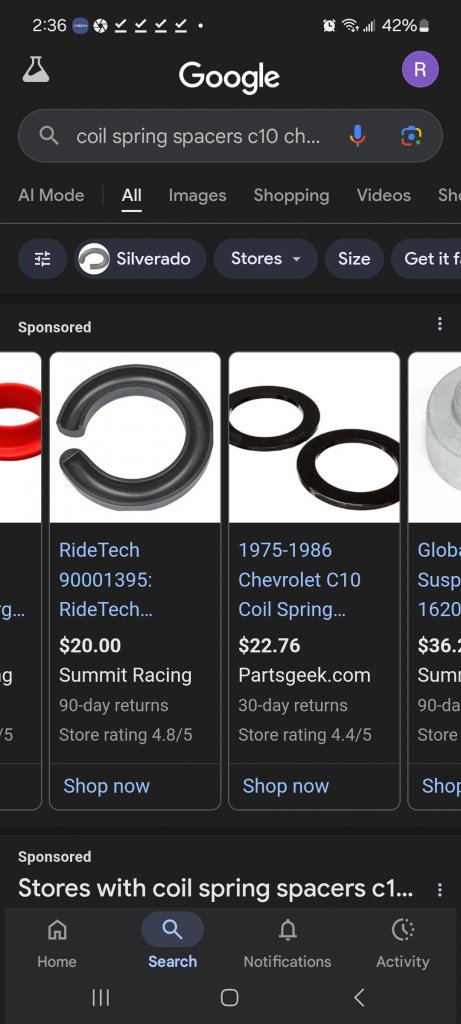

If you need to end up raising it,coil spring spacers are cheap and easy depending on who you believe 3/8th will get you an inch,others say 1/2"will get you an inch
