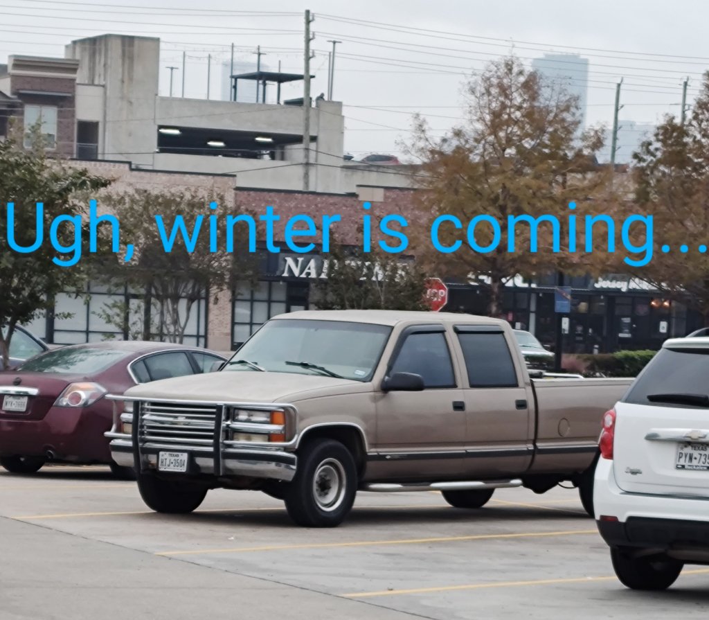

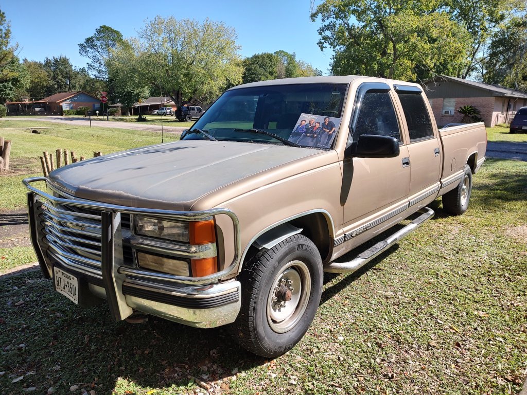

No idea what brand, came with the truck. I have two similar ones in the shop, neither entirely complete. Got one at the U Pull And Pay a couple years ago on 50% off day, paid around $25 for it. The other one came from a friend on gmt400.com who bought a dually and didn't want it on his truck. He's going for more of a lowered beater look....
Does get in the way some when doing repairs, but also a good place to brace yourself on the front of the truck.
