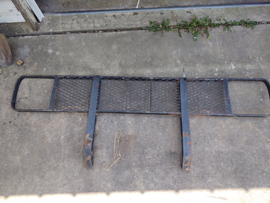

I found and ordered some cage nuts from Grainger on Monday, and picked them up yesterday over my lunch break. I couldn't find any designed to accommodate the ~0.2" plate, but I got some that were close and tweaked the steel cages by hand (pliers). That was much simpler than getting the old cage nuts and torched bolts out. There's limited clearance between the cage nut and the steel behind it, which made it a PITA. This also means proper mounting bolt length will be important on the top bolts.
It's ready to go on now whenever I can make time to mess with it again, or I have to cut the grate out. I still haven't decided on that.
Pix...
Cleaned out the old hardware
Cage nut comparison before and after reshaping the cage a bit. I got a little better hook/grab on the cage by bending it to final shape while it was in the brush guard.
Ready to go.

Easy big fella'! I ain't got it on the truck yet. I'll post before/after pics of the truck when I get there. I went fishing last night and didn't have time to mess with it.
I think I'm going to change focus to my windshield this weekend while I stew on the grate decision. To cut the grate out nicely, I'd have to do it off the truck to have good access to the welds. There's only four small welds on each side grate, and six small welds on the center grate. Maybe I should mount it and then decide? It's just a little more messing around, right?

After reading your post I picked up one myself. The bolt holes line in the bumper, I want to keep the grate and see if everything lines up well. Then I think about a repaint.

I got the brush guard mounted over the winter, and finally got the truck outside for a picture. It was certainly worth the modest investment.
