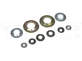

hey guys, new question on this rig. I was replacing my driver's door pins, and broke both of those little retaining clips, prying them off the ends of the door pins. Anybody know what those things are called? I can't find any, and it's probably jsut because I don't know what words to type in.

Let me know, if you know what those little clips/push nuts, whatever they're called, are.

New door pin and bushing kits generally come with new retainers. The original type round ones would be called starlock washers, push on lock washers, etc. The rectangular ones that often come with aftermarket pins probably have an assortment of other names.
