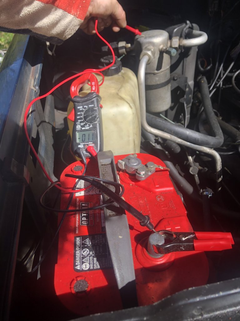

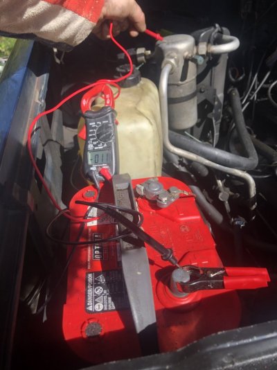

its a bit chilly outdoors so i dont expect super accuracy with my multimeter but bat pos to frame usualy yeilds 0v.
Bat pos to block ground is much easier to get 11 o 12v same goes for chaassie ground to batt pos
I have a few ground wires connected to frame by the hood , perhaps this is the problem all along. I can get 11 or12v at that wireand on that bolt there but if i go to touch just an inch over on the frame i get 0v.. I always thought it was correct because chevy put it there. !!!

Can ground to the aluminum thing by the heater core it seems to pick up a ground quite well
