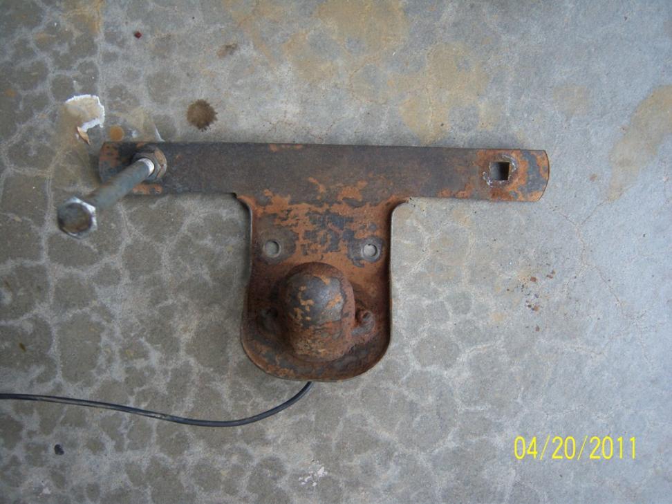

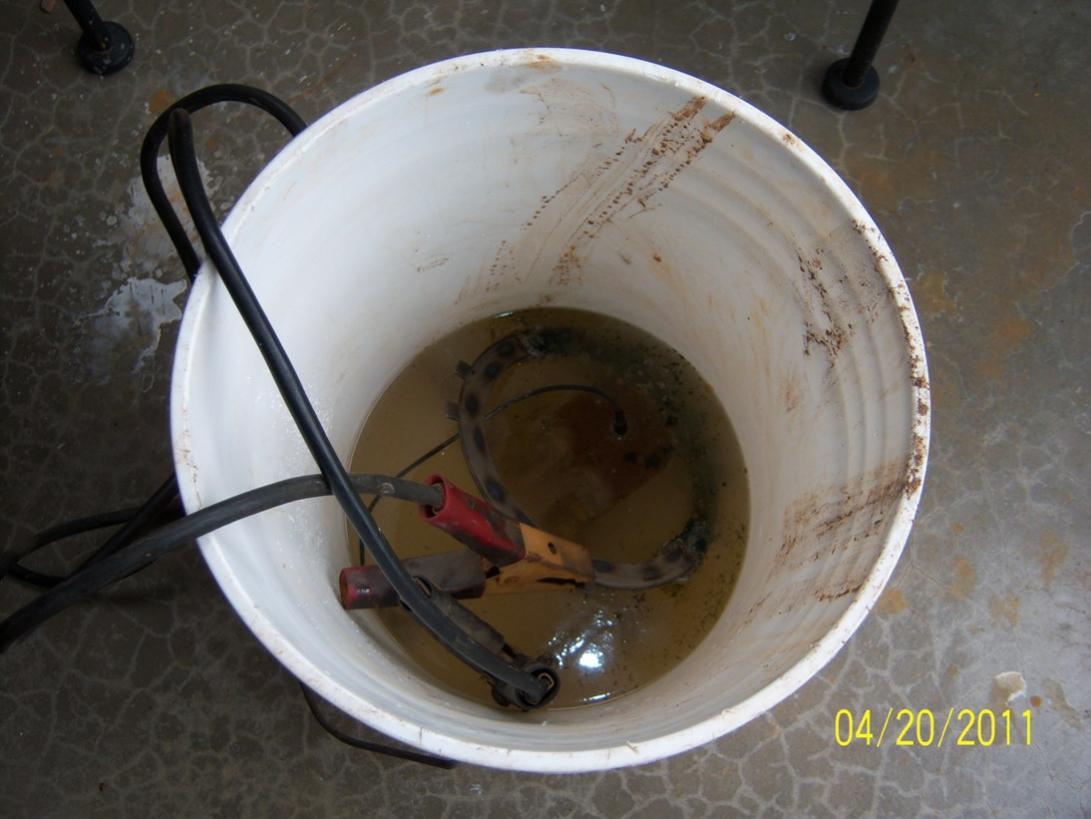

In this fuggin city I live in, cops pull you over for no license plate light. Just to be pricks and have an excuse to pull you over and make sure you aren't under the influence, and have insurance, no warrants etc. They don't even write a ticket for it. They don't want you to fix it cuz then they can't pull you over anymore. I was pulled over 2 times in 3 days, once in each of the drivers, the 85K1500 and 84C20. I hooked up the lights in the bumper on the 85K1500. But the 84C20 has that redneck homemade stop a freight train Git'r Done bumper with no light. On the 85K1500, I seen the OEM license plate light and bracket behind the bumper. It'll work great on the 84C20. It was rusty as hell, so here I go. Gonna clean it, paint it and put it on the 84C20.
47,817
10,952

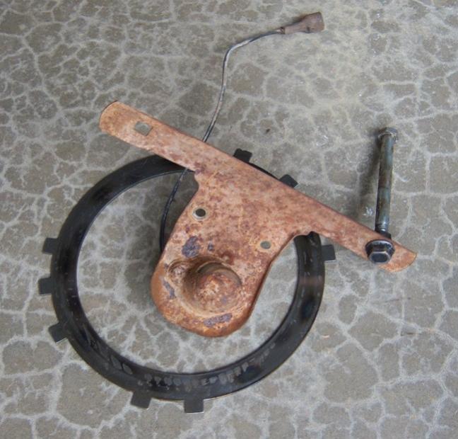

Using an automatic transmission steel plate from a clutch pack.
Before
attachment.php
Starting up !!!
attachment.php
About 5 minutes into the process.
attachment.php

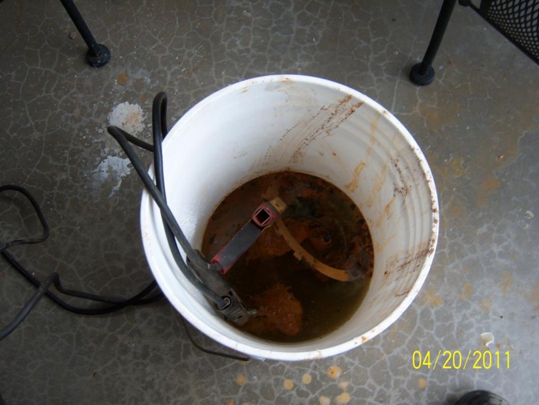

More pics as the process progressed.
After about an hour.
attachment.php
After about an hour an a half.
attachment.php

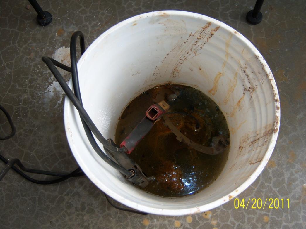

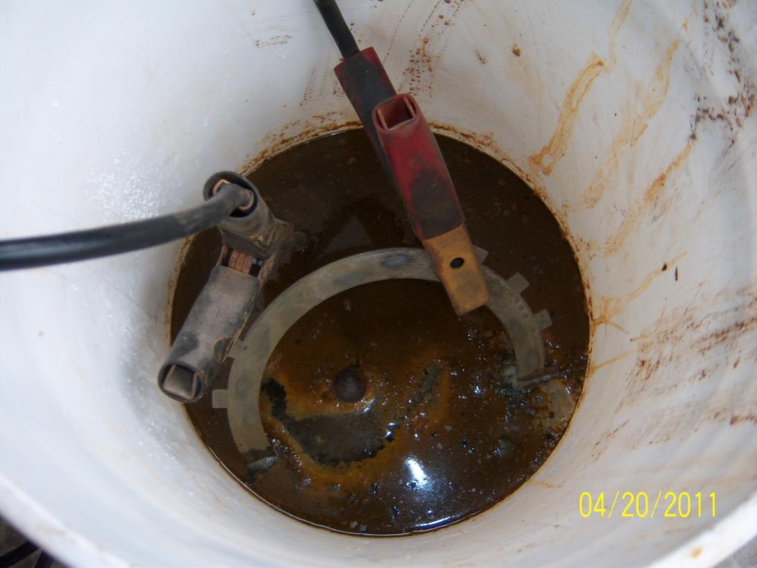

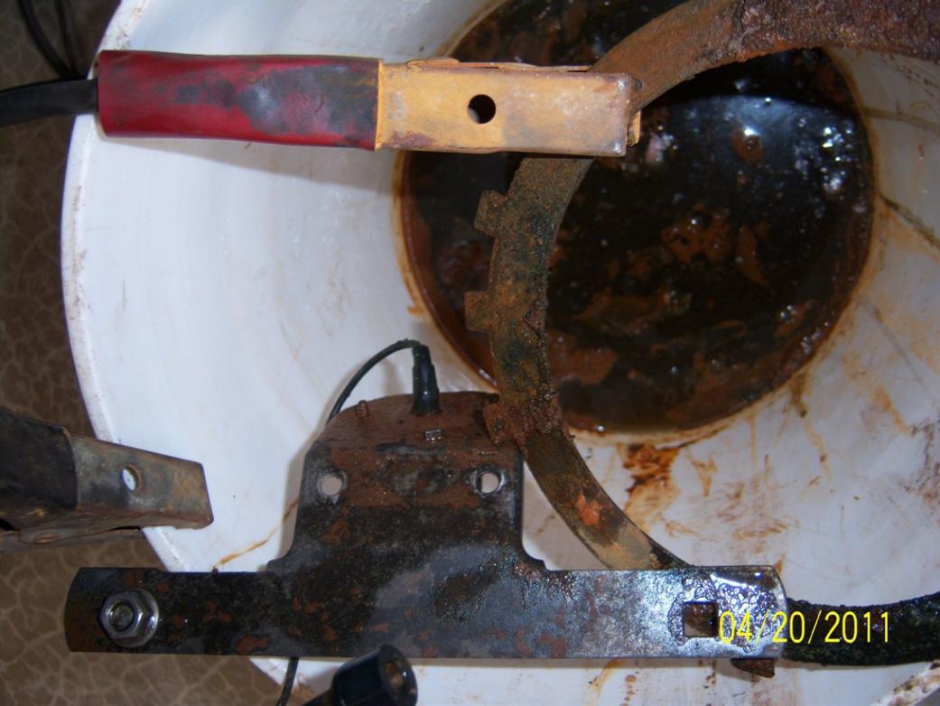

I pulled it out to check it. It looks like it was making good progress, but it slowed way down. I also had cleaned the steel off a couple times and its getting very funky quickly.
I notice it seems to get cleaner near where the lead is clamped to the part first too. You can actually see the bubbles in the water coming from where I have the bolt in the part.
attachment.php
I'm begging to think the electrolyte is now so funky, its slowed the process down, and the funk that is clinging to the steel, is actually coming from the electolyte, not the part. I think the electrolyte getting so funky has slowed or stopped the cleaning process. Also, notice, I don't have alot of water in there, so it likley diluted to badly.
attachment.php

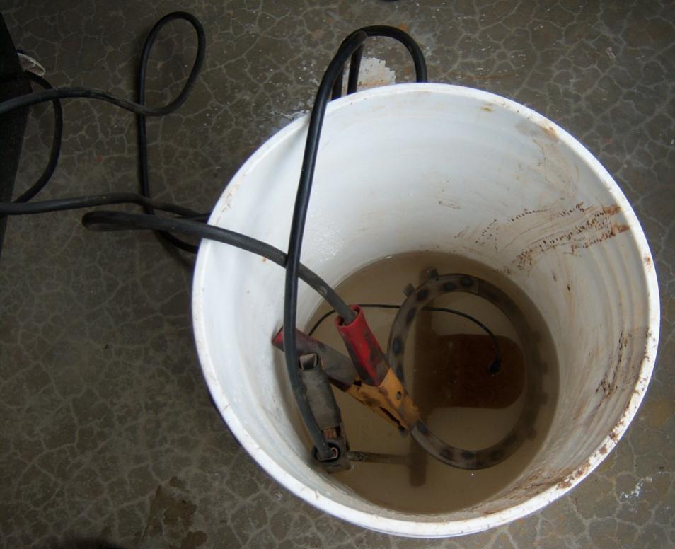

So here is what it looked like when I decided to start over with clean water and washing soda making new clean electrolyte.
