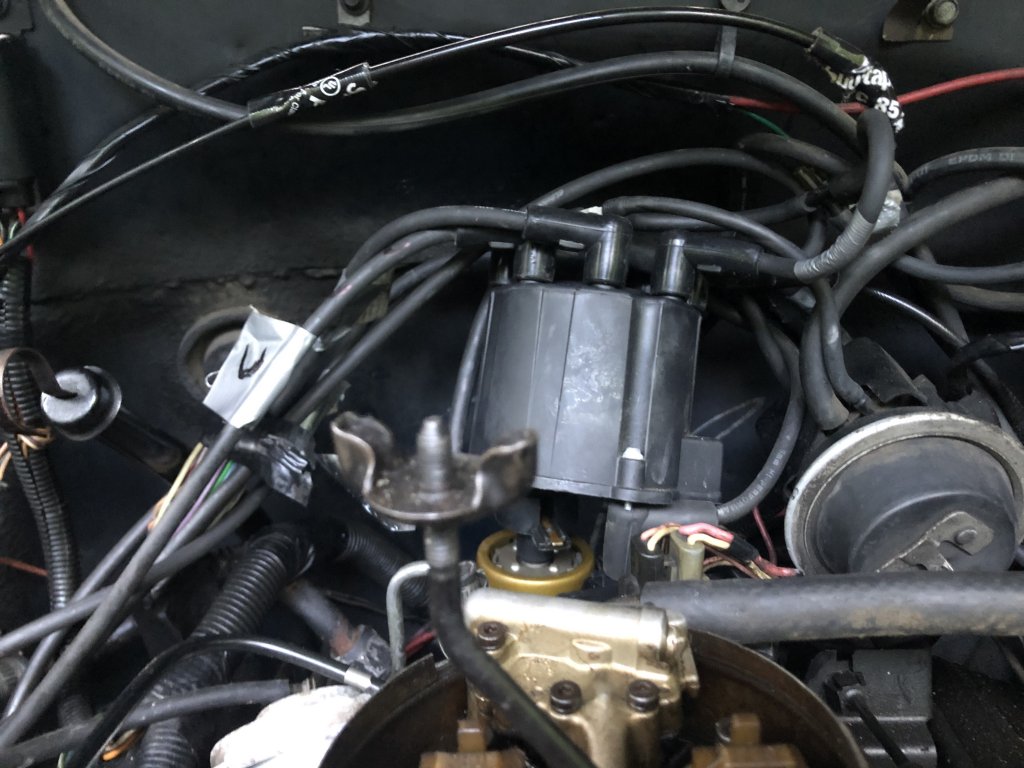

The rotor is pointing right between the #1 and #2 ,should I move my plugs?

It’s too far retarded if rotor is between #1 and #2 right?

I tried to start with rotor between #1 and #8 .... still no start seemed too advanced and actually had a burnt plastic smell hmm

I tried twisting the distributor all sorts of ways still no start. Had the rotor lined up with number one still no start. Tried advancing and retarding still no start

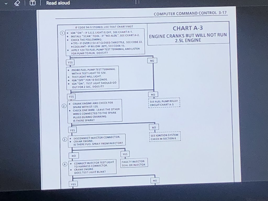

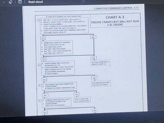

Ok I found it , I thought this would be easy lol but here is the first chart I came across thanks
make sure you have the right chart for your engine.
also, I'd be sure to trace all the plug wires to make sure that they are all in the correct spot and order on the cap.
