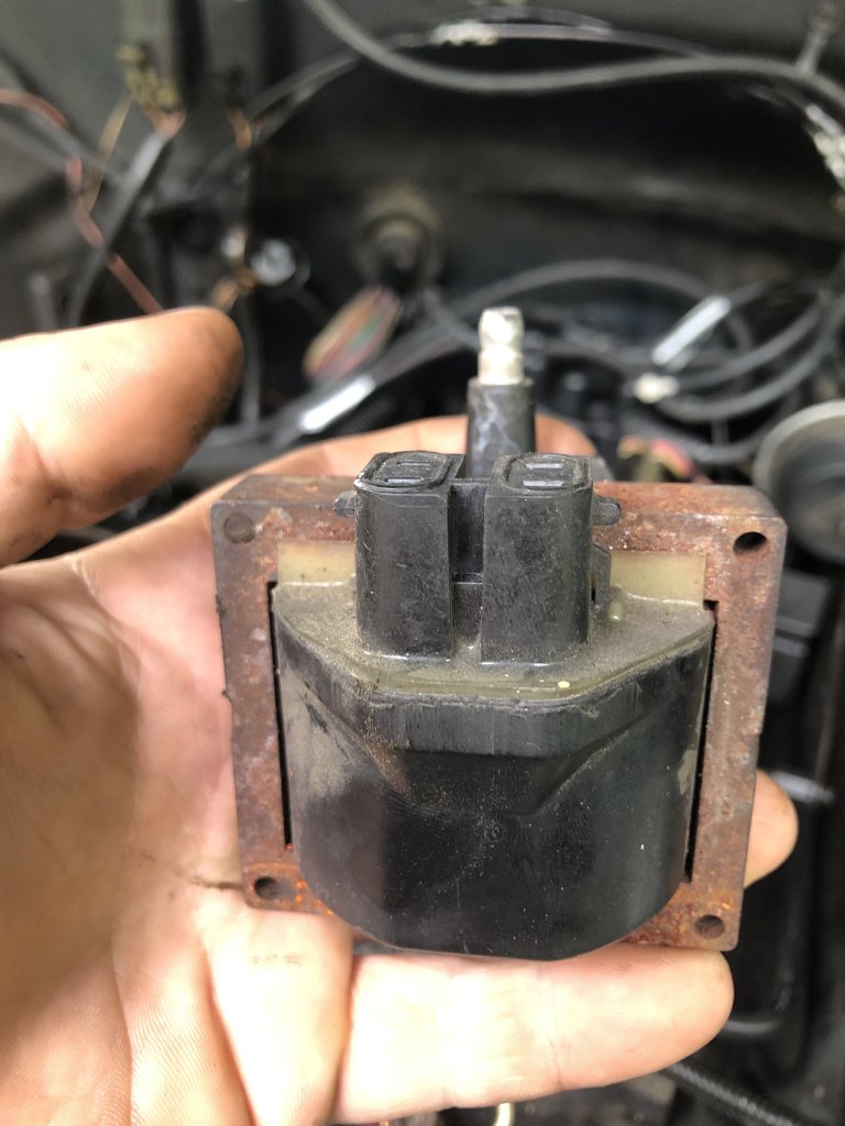

How do I test this silly “ignition coil” I also have an older “ignition coil” in my hand no clue if it works

Try this for your ignition coil:
From personal experience I can tell you that as far as testing the pickup coil goes, they can test good and still be bad. Vibration and heat are factors that you cannot reproduce when testing. If you must, they should read between 500 and 1500 ohms. I usually see them around 900 ohms.
IMHO, they're easier to replace than mess with.

Just tested my ohms it was all “00000000” on my 1st meter and “.025” on another meter

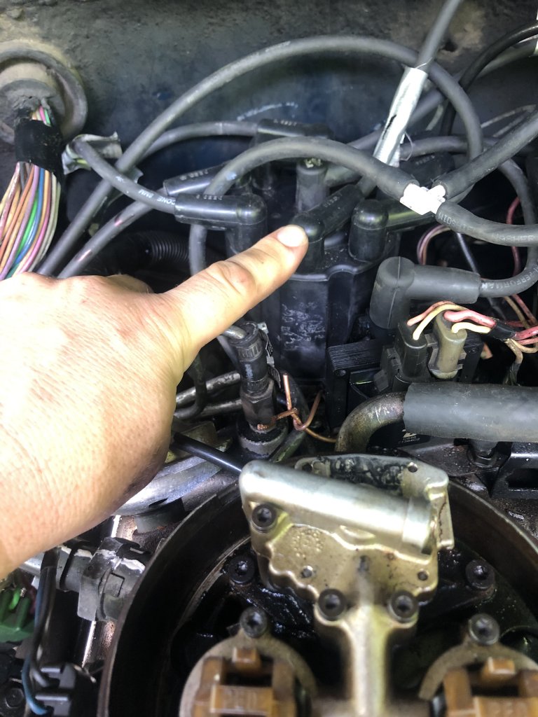

The pic you posted with your finger on the terminal I'm almost positive is #8. Did you mark the wires when you changed the module out?

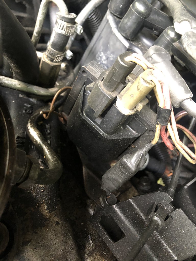

I marked but I may have made a mistake the one I’m pointing to here is going to the #1 cylinder is that correct

This should be going to cylinder 1 correct?

I got the plug I’m pointing too on #8 she cranks but still no start

I'd say that's unlikely the timing chain jumped. did you pull the distributor before? I can't remember. if you did, you needed to restick it just how you found it when you pulled it or you needed to find top dead center on No 1 and stick it with the rotor pointed at No 1.
